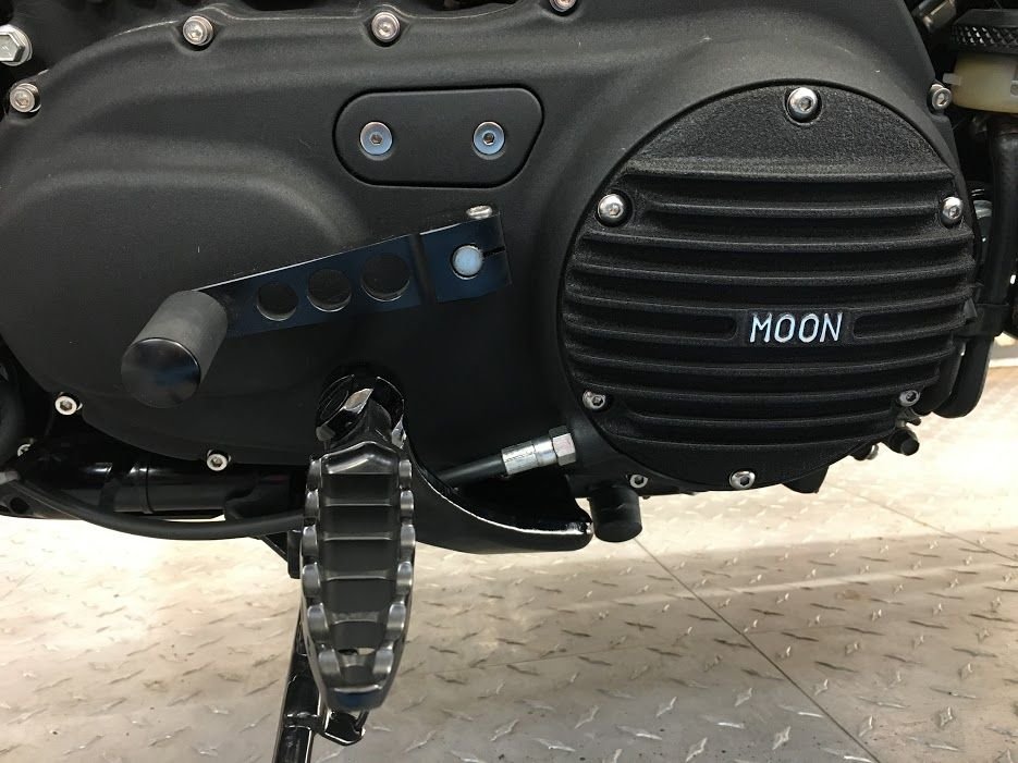

Originally Posted by WKNDS
Since you are having to acquire the mid-mounts, have you considered the 'further forward'
version from the 'T' model ? I switched my Iron to the further forward mounts and I find
it to really help my old knees from getting as 'stove up' from being bent further back with
the stock mid-mounts.
New 'further forward' version
Further forward mount compared to the stock mid-mount
hth,
T.
Please enlighten me as to the Sportster "T" model. I've assumed this was an accessory item only?
If you are piecing this further forward kit together as I have, may I suggest the Buell Blast shift arm as it's just enough longer than the stock XL shift arm to be a perfect length and it's a bolt on.
Here is a pretty good description of the XL1200T SuperLow
https://www.motorcyclespecs.co.za/mo...xl1200t_17.htm
Notice under the 'Fit' section:
- Two-up reduced reach seat features narrow nose
- Mid-mounted foot control position, 3 inches forward of other Sportster models
- Rider mini footboard
Yeah, obviously, the stock length shift arm will not work (as shown below)
hth,
T.
