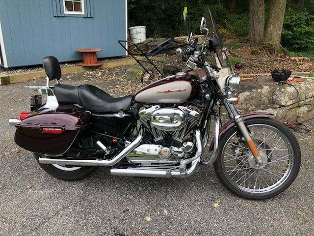

That is what I have done here with a 2008 Custom. Forward controls with the mid footpeg as well

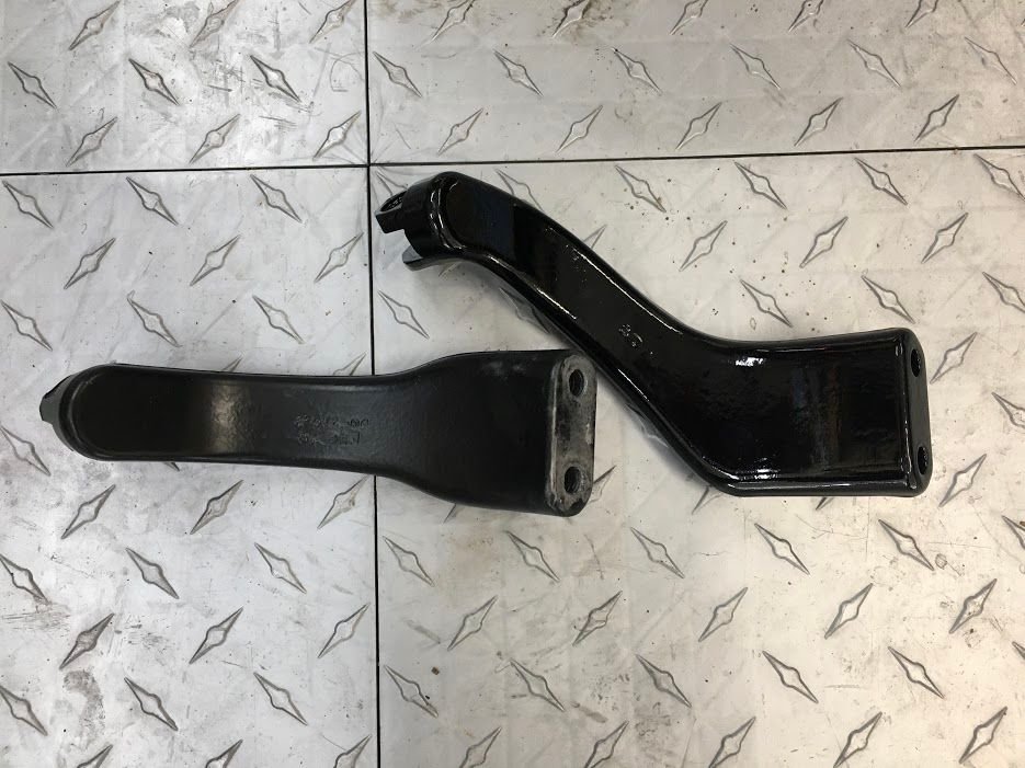

Since you are having to acquire the mid-mounts, have you considered the 'further forward'
version from the 'T' model ? I switched my Iron to the further forward mounts and I find
it to really help my old knees from getting as 'stove up' from being bent further back with
the stock mid-mounts.
New 'further forward' version

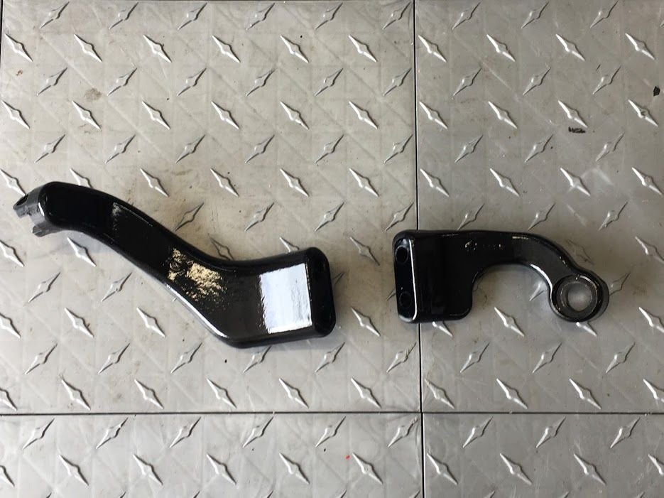

Further forward mount compared to the stock mid-mount
