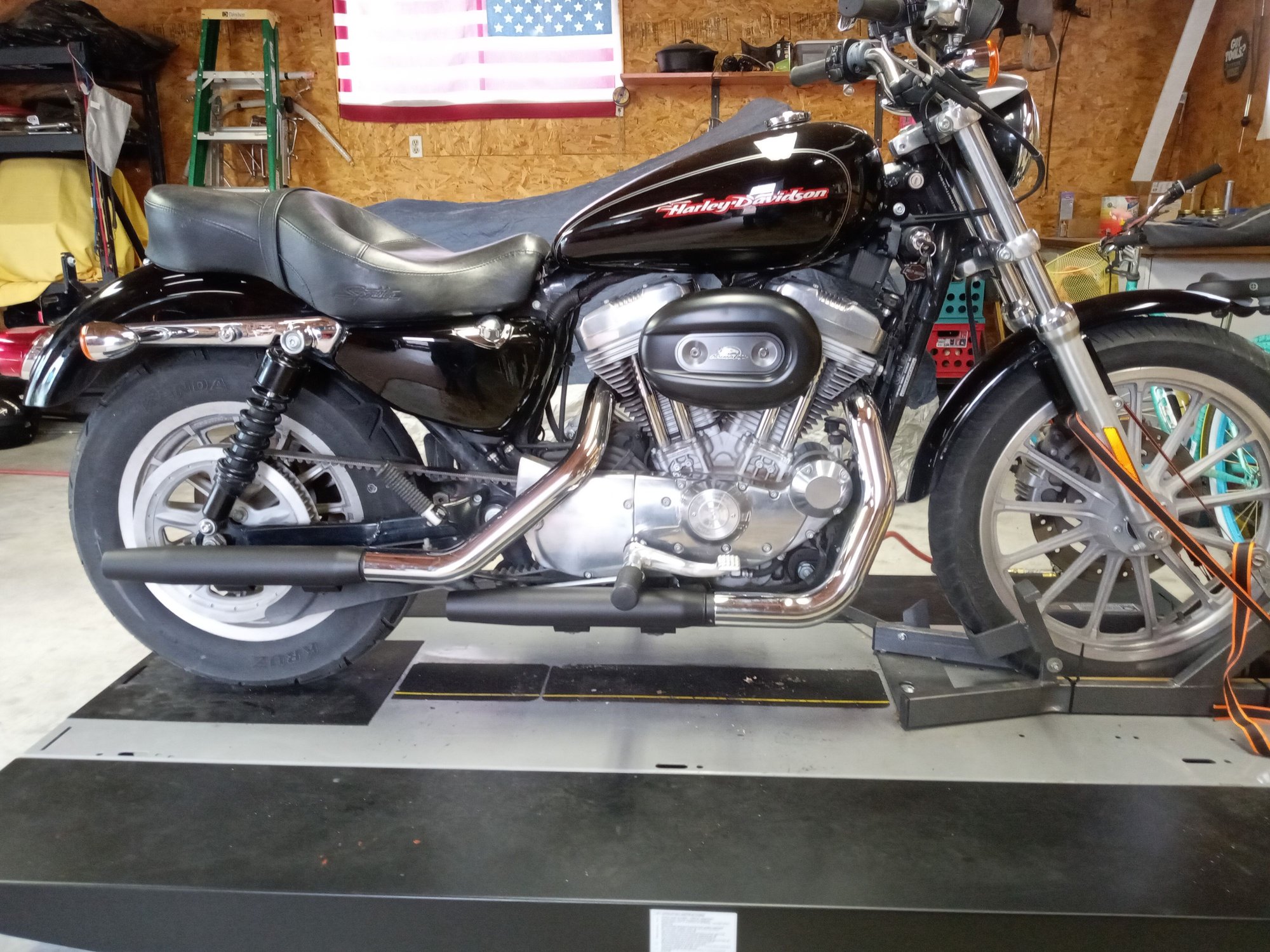

Just picked up an 05' xl883 a couple of months ago, 14,500 miles. Had not been started since 2015. Got all of the fluids changed and it runs perfect but it seems like the clutch pull is excessively hard. Twice that of my Road King or my privious Ironhead. Is that normal?

Previous owner put a stiffer spring in it, would be my guess.

And/or the clutch cable needs to be cleaned/lubed or replaced. The grease/oil in the cable may be old & hardened.

PO said all stock so doubt heavier spring. Will give cleaning cable a try. Thanks. At $2,000 I couldn't pass it up. Got both tanks and seats with the bike and many other items.

Lube the clutch cable with cable lube (or even motor oil is fine I believe) first. If it's still a strong pull, you'd either need to install a softer diaphragm spring (if it was indeed upgraded), or consider replacing your clutch ramp mechanism with one that has a longer arm (I installed a Muller clutch ramp on my bike and like it a lot), or both.

There have been a lot of threads on this and it is somewhat subjective. Personally, I think the stock clutch pull on the sportster is very stiff (with everything fuctioning properly) compared to any bike I have owned or ridden. I ride a 2003 and the stock clutch action will have my hand cramping in an hour of city riding. The rubber mounts I have ridden felt the same way generally so I would say that it's normal.

A knowledgeable member over on XLF said one of the aftermarket diaphragm springs was a better design (maybe Energy One) and was an easier pull even though it was an upgraded spring with more pressure. IDK, maybe someone has tried one? It wasn't the judder spring mod he did to his bike, just a clutch/spring upgrade.

My bro in law has a 99 Sportster that will break your damn hand after a few pulls.
I have an 07 Sporty that is like butter compared to his.
Start by lubing the cable real good and go from there.
