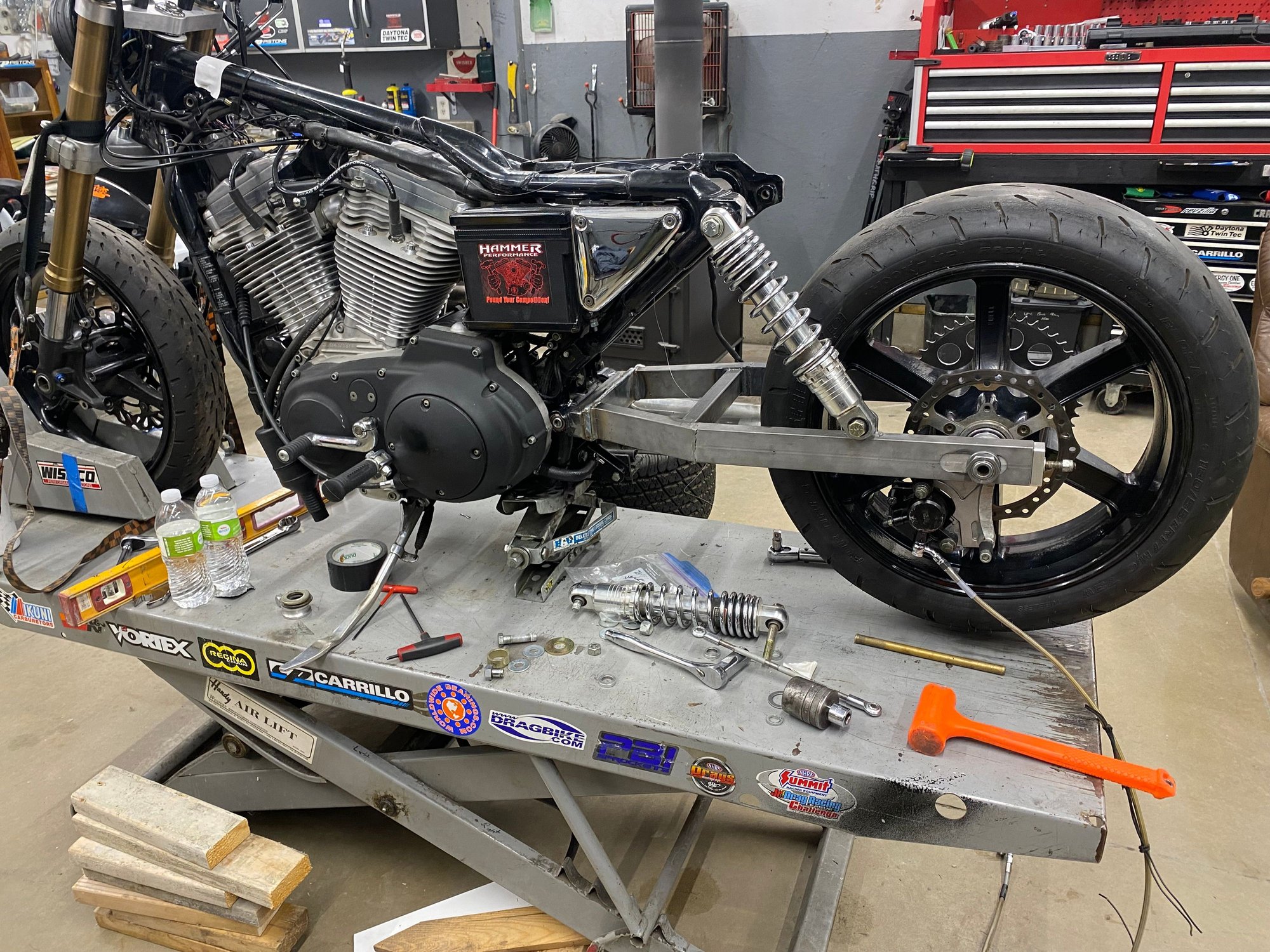

In it to win it now! Haha! It’s shortened, but needed to be moved over a 1/2”. Hopefully tomorrow we get it welded, mounted and wheel in place.

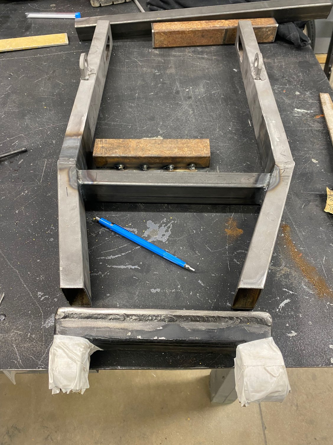

We are not proclaimed fabrication guys at all! Pretty crude! I think we are gonna clamp it up on the table and square it to the world as best as possible. 🤷🏽‍♂️ Tack it then see if it’s gtg. Any pointers?

Send it!
maybe a gusset in each corner?

Looks pretty clean. I agree with Paintslinger, some small corner gussets would make me feel better
Nice work!

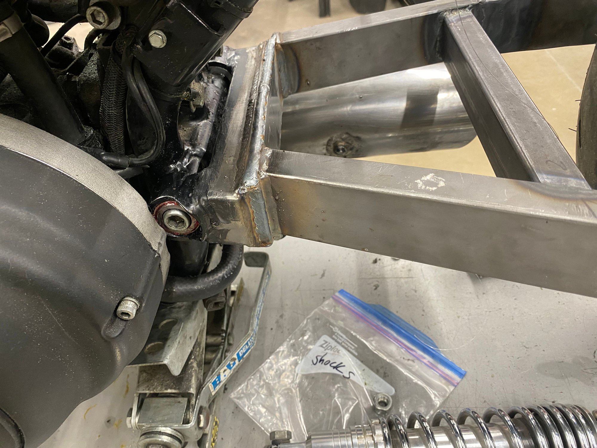

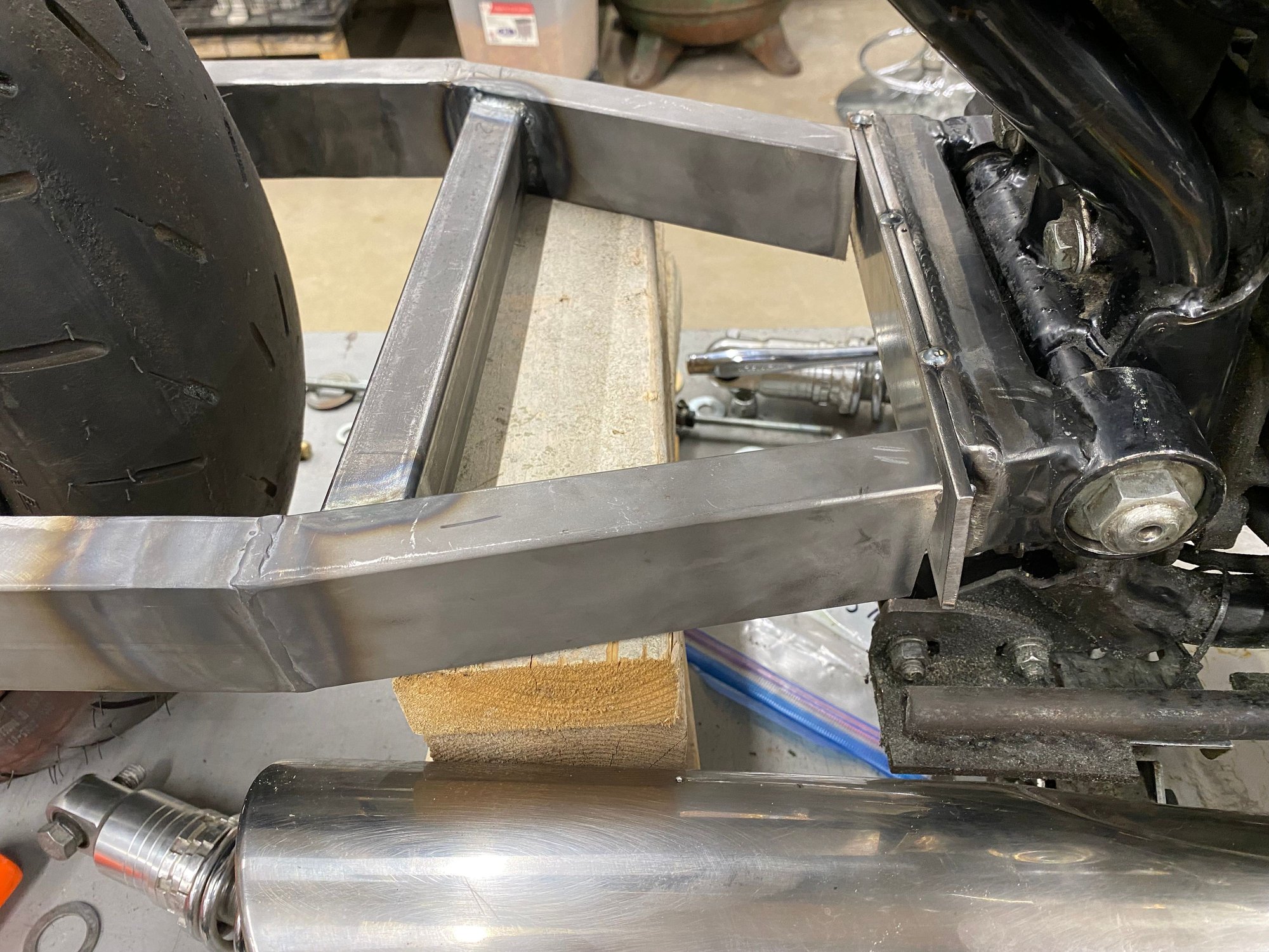

welded, moved entire arm over 7/16” to the right. Now the wheel is running dead center. Gonna need a 1” offset sprocket now, not 3/4 . Will add gussets later and will tidy up the looks of the offset steel by the pivot
