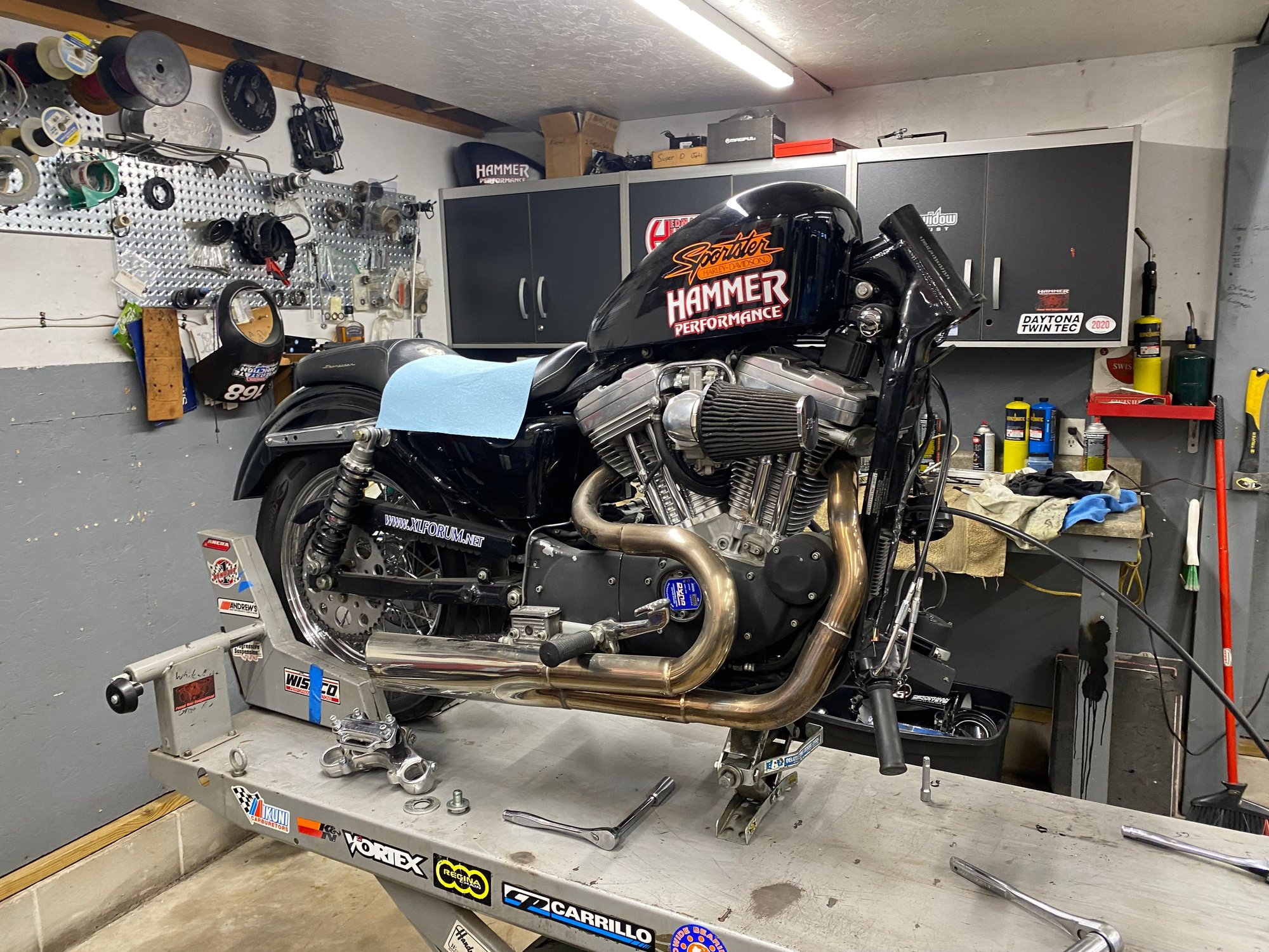

Gsxr front end going on my sons 2003. Along with an EBR magnesium rear wheel and a 2”-4” stretch in the arm. Probably run a cafe ish rear end on top of the 180. Dropping some serious poundage!

Ok, 6” stretch. That’ll give us a 64.5” wb. Perfect for that 10.99 😉

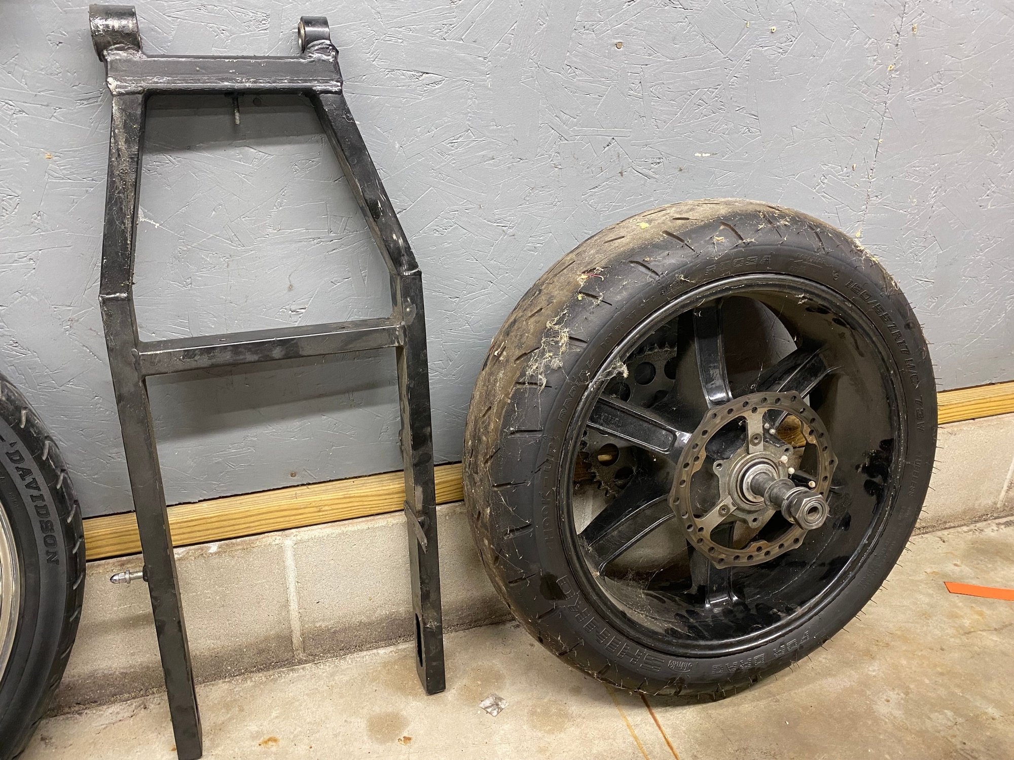

Riser holes punched through the triple tree, bars on. Swingarm dropped off to have new slots milled in for the axle/axle block. We’ll cut the cross brace and weld in new cross brace, chain guard tap and battery tray iiiiifff we have room. Mostly reusing old parts so we should make pretty good time. Gonna dive into homemade fiberglass work for the seat and fender. Wish us luck haha Not much out there for cafe ish fender seat set ups that we like.

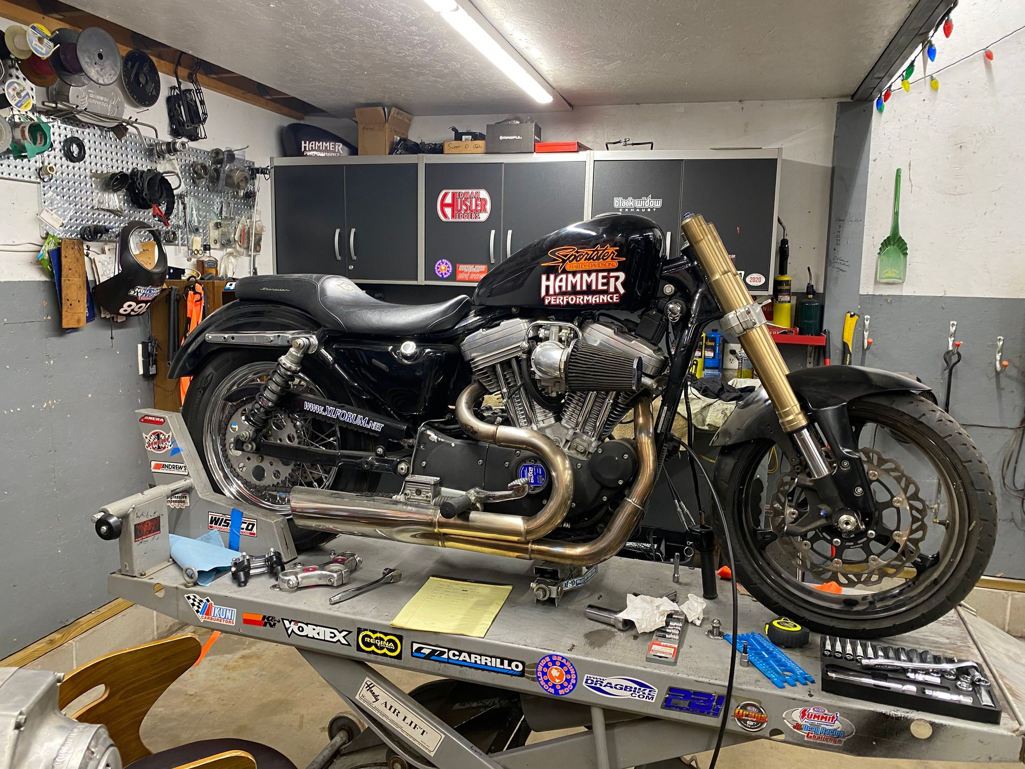

Waiting on the swingarm slots to get milled in and get it picked up before we can mount wheel and get going on the tail section. Wheel is sitting at 64.5” wb.
