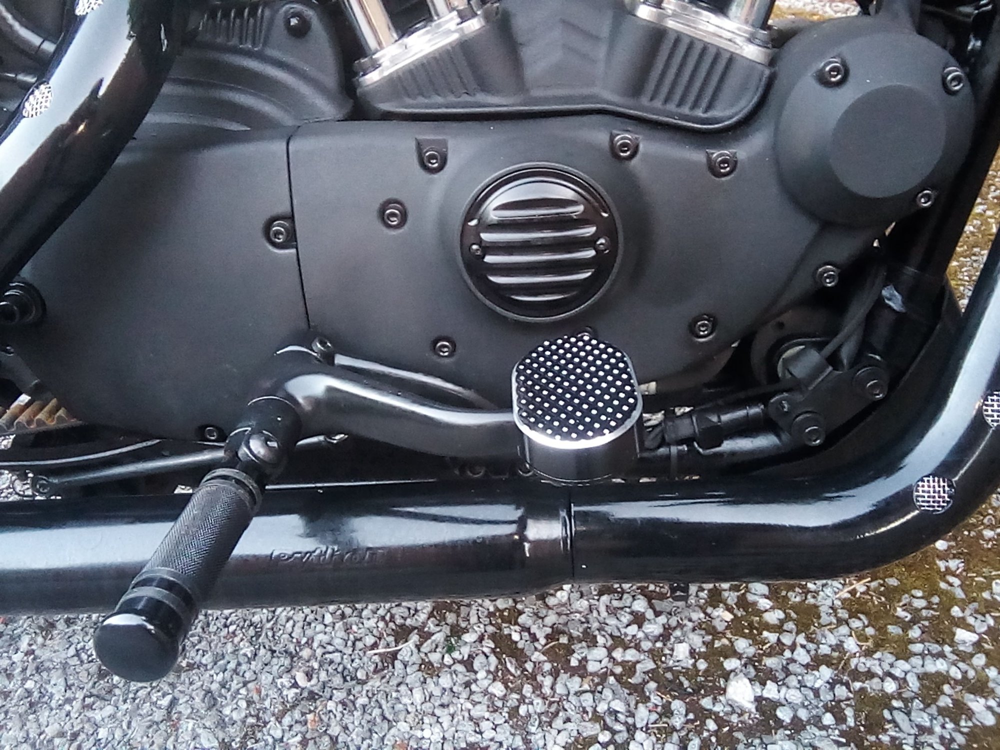

I used Hycote Truck Bed Liner paint on my starter motor cover and cam lifter blocks cover, it matches the H-D wrinkle finish.

I was considering doing that too, then I remembered having used this paint before and decided to try it.
Now I'm trying to decide whether to pull the trigger on a $70 polished stainless bolt kit from Ebay.
