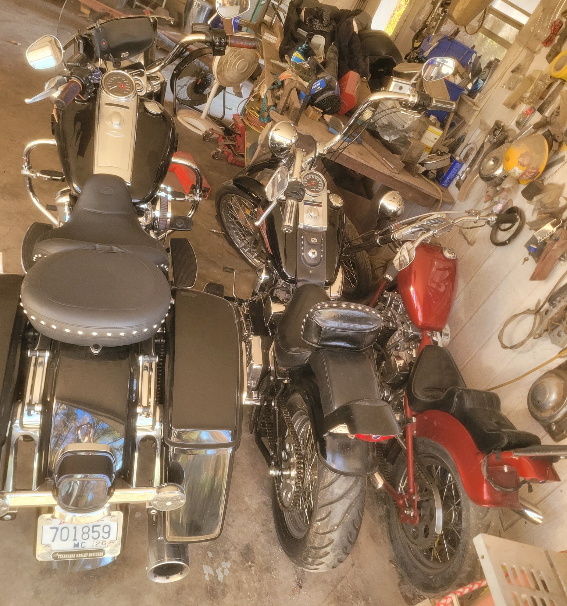

3 bikes on myside of garage and guess which one rides the roughest!
Yep, the center 91 "softail".
I personally, as someone mentioned have run a max of 16psi on all my hardtails since the early 80s. (1 up)
Actually have 2 more hardtails as well, and the old softails never rode as good as a hardtail that is set up correctly. Up until they finally went to a wide rear tire. And the newest 2018 and up softails with the new single shock rivals the touring bikes in ride quality.
The softail old softail is too heavy to run pressures so low and again the 1st generation was merely an overweight hardtail in my opinion.
Sorry don't know about your 2 frame choices.

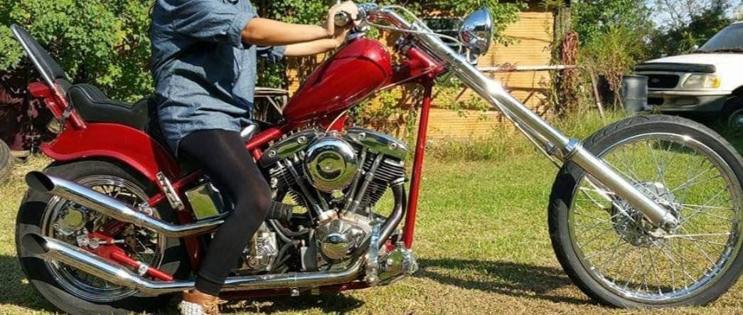

My red chop has a modified Paughco frame, as I removed the ugly side gussets and installed inner support.
It is a very light molly tube frame that you can pick up with 1 finger. My other 2 hardtail HD frames takes both hands and arms. My heavy 128" touring bike 130ish hp & torque can't catch the light hot 80" Shovel chopper if she takes off 1st. Rolling sure....
We NEED MORE HARDTAILS ENTHUSIASTS to make the world look better!
Niece on bike and sister would kill me.🙃
