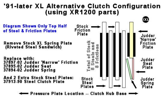

Originally Posted by Andy from Sandy
(order of fitting)
37895-02 SEAT, DAMPER SPRING
37894-02 SPRING, CLUTCH
37897-02 FRICTION PLATE, NARROW
It is not just 2 metal rings it is also a half width friction plate so 3 parts to the install.
So do you sandwich these 3 between the 2 steel plates?
Old Mar 14, 2024 | 01:04 PM
Andy from Sandy's Avatar
Andy from Sandy
Community Influencer
Joined: Sep 2017
Posts: 12,254
Likes: 4,946
From: England
The 3 parts replace the first fibre plate. After you put these 3 parts in you then put a steel plate in.
The fibre plate you didn't put in you sandwich between 2 steel plates to replace the spring plate.
So in addition to the XR parts you need to purchase 2 steel plates as well.
The fibre plate you didn't put in you sandwich between 2 steel plates to replace the spring plate ...
Aha, so I remove the entire stack of friction/fibre and steel plates then I put these 3 in. Understood. After that I alternate steel, friction, steel, but when I reach the spring plate, I replace it with a steel/fibre/steel combo instead. Thank you.

Originally Posted by lewk
That's a very helpful pic thank you. The friction and the 2 steel plates are easy to figure out, but do you have the instructions where to use the other 2 metal rings?
You are welcome...the judder sping, spring seat, and narrow plate are installed as below, the picture is from Sportsterpedia

Here is what I believe to be a much better installation picture for the parts:-
#21 = 37895-02 SEAT, DAMPER SPRING
#20 = 37894-02 SPRING, CLUTCH
#23 = 37897-02 FRICTION PLATE, NARROW
#29 = 37913-90 STEEL PLATE
#28 = 37911-90 FRICTION PLATE (PAPER)

There are a lot of explanations on how to convert the stock setup to the XR setup, but I made my own to fully understand in the simplest way possible. Here's the image I needed to see when I was trying to visualize it. Please let me know if it's incorrect and I'll update it.
