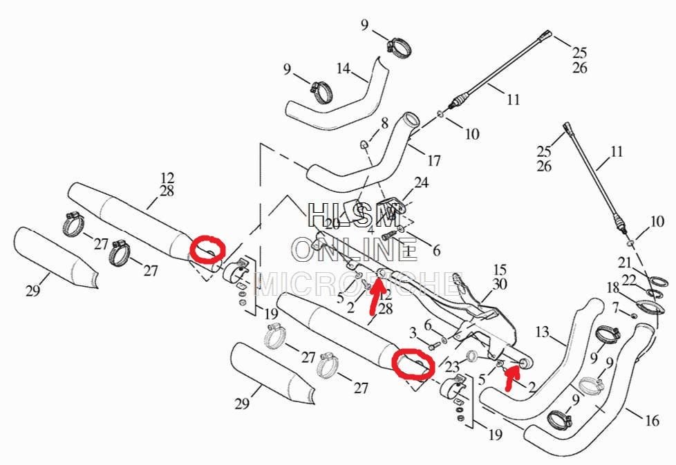

The mufflers for 2004 to 2013 have a big hole in the side for the interconnect pipe. They would be open on his 2022 with the way the interconnect works on that bike.

Will mufflers with holes in the side open to the air work without issue?
Will a leaking exhaust pass inspections?

Pictured is where the interconnection goes at the muffler.
Sure enough, I also looked it up!.. But you wouldn't want screamin eagle mufflers from those years anyway just like you wouldn't want the late model cat ones either.
