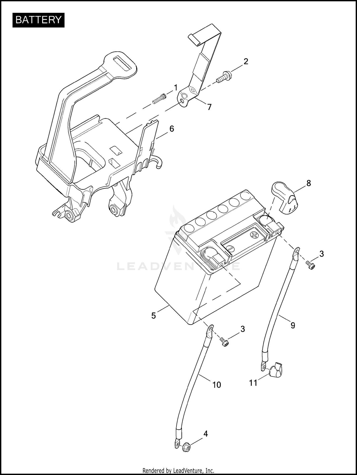

Originally Posted by 08xl1200r
I had chronic issues with the terminals loosening on an aftermarket battery so I switched to an AGM battery from my local HD dealer and no problems since...no spacers required and no nuts either, the terminals have steel threaded insert cast into them.
Hmm.... Thank you for the diagram, I like it. I will check into what HD has to offer for their battery selection for the Sporty.
