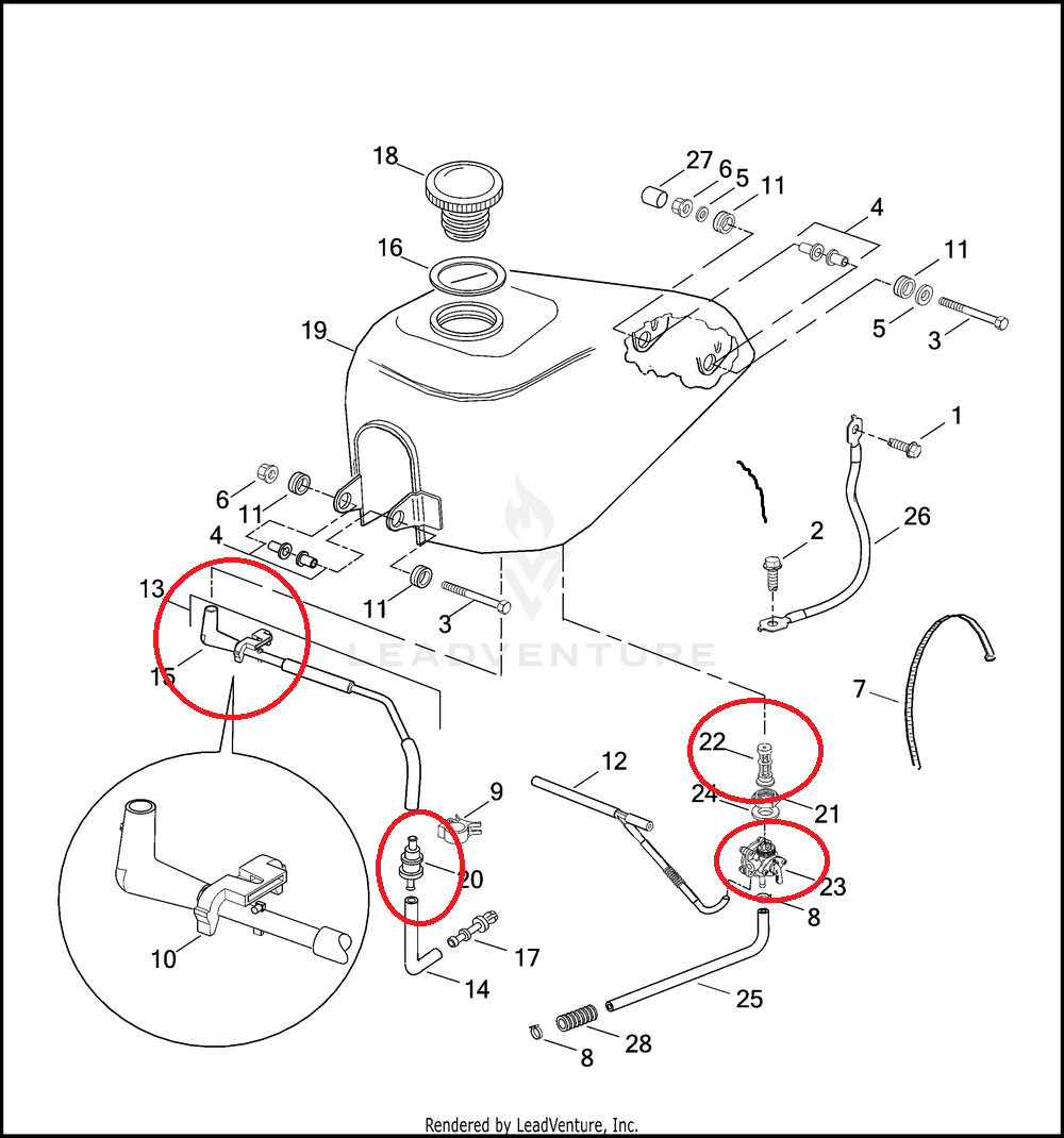

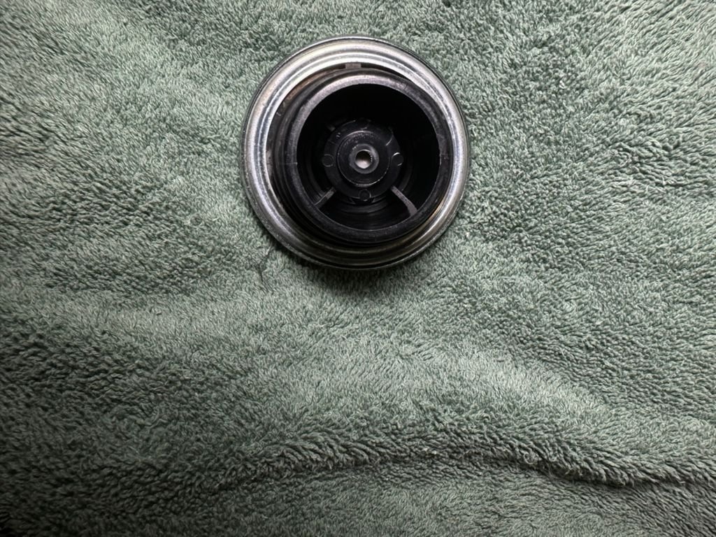

1. Fuel delivery is still suspect.
2. Do as Chopper Man said, check the cap for venting, may be not working correctly. Loosen cap and see it it makes a difference.
3. Inline fuel filter could also be suspect, should not be required if petcock has filter screen as shown in the diagram I provided.
4. OEM Gas Cap or aftermarket with venting?
5. See pictures below from OEM Tank and check for vent tube, vent hole, and cap vent.
