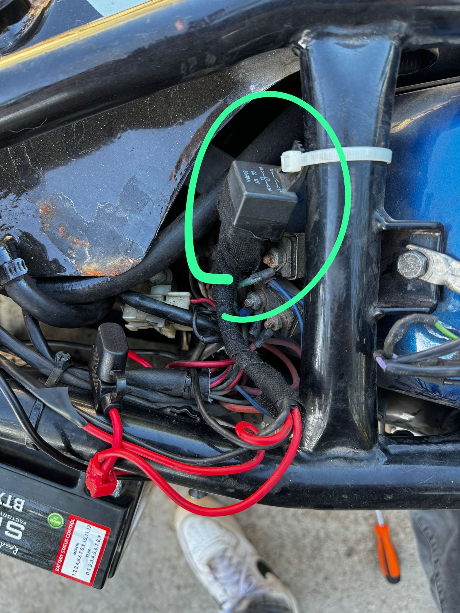

The horn issue sounds like it has a bad ground. Take the horn off clean around the bolt area and reinstall.

im not sure why but someone decided to connect the relay of the horn with a fuse, not something stock but they did, and it was a bad fuse now the horn work.

So looks like the previous owner added a direct charging line to the battery and also piggyback the horn relay to the same positive line.
the charger had a fuse connection and a bad fuse inside.
so far the only change I did was to remove the battery charger and add some temporary insulation until I’ll get my heat shrink insulation.im Also thinking about turning the battery to the other side and extending the wires because right now the terminals are so close to the frame I’m sure with the vibrations it’s a matter of time before I’ll have a circuit short in my future
The horn relay

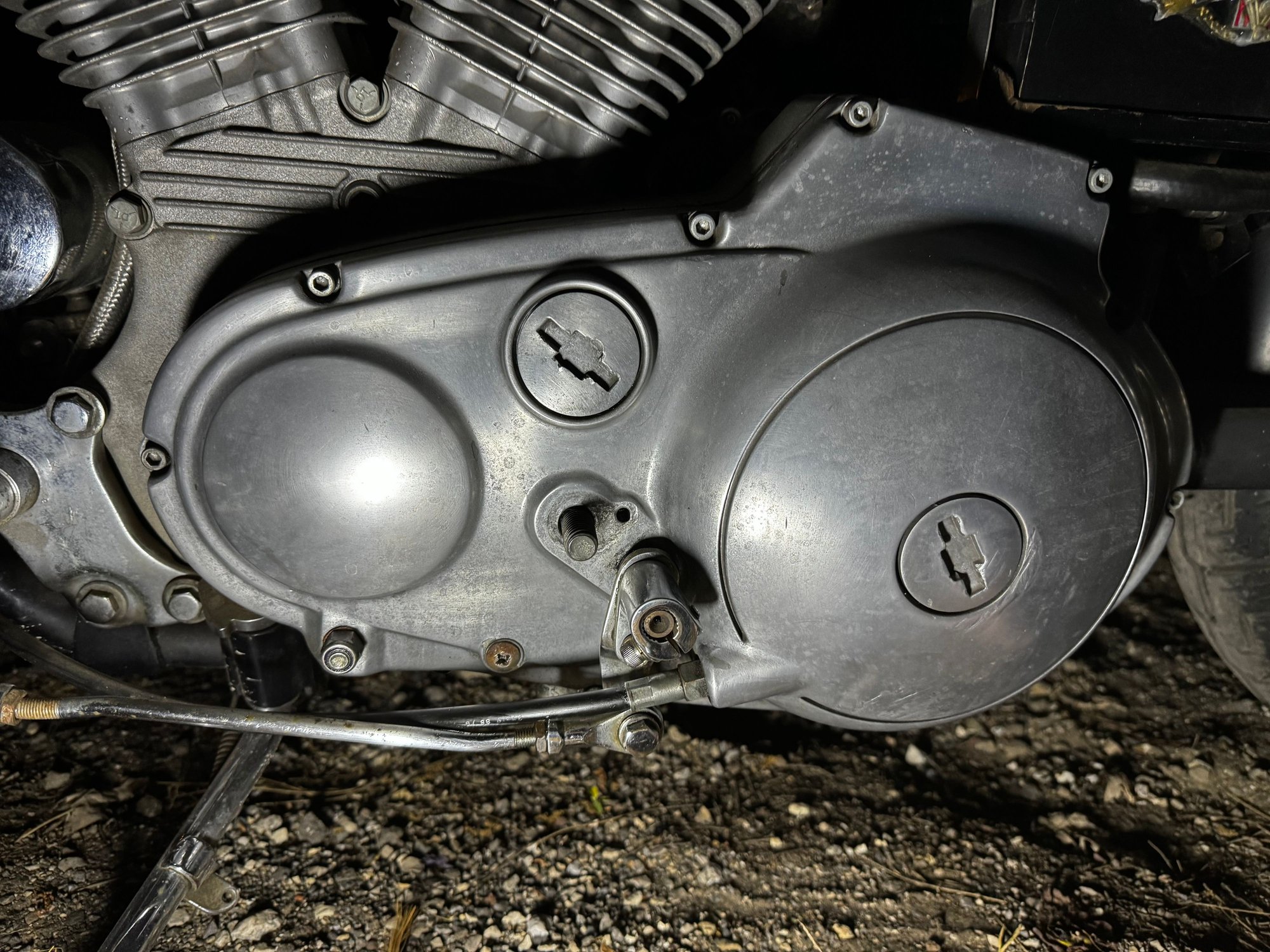

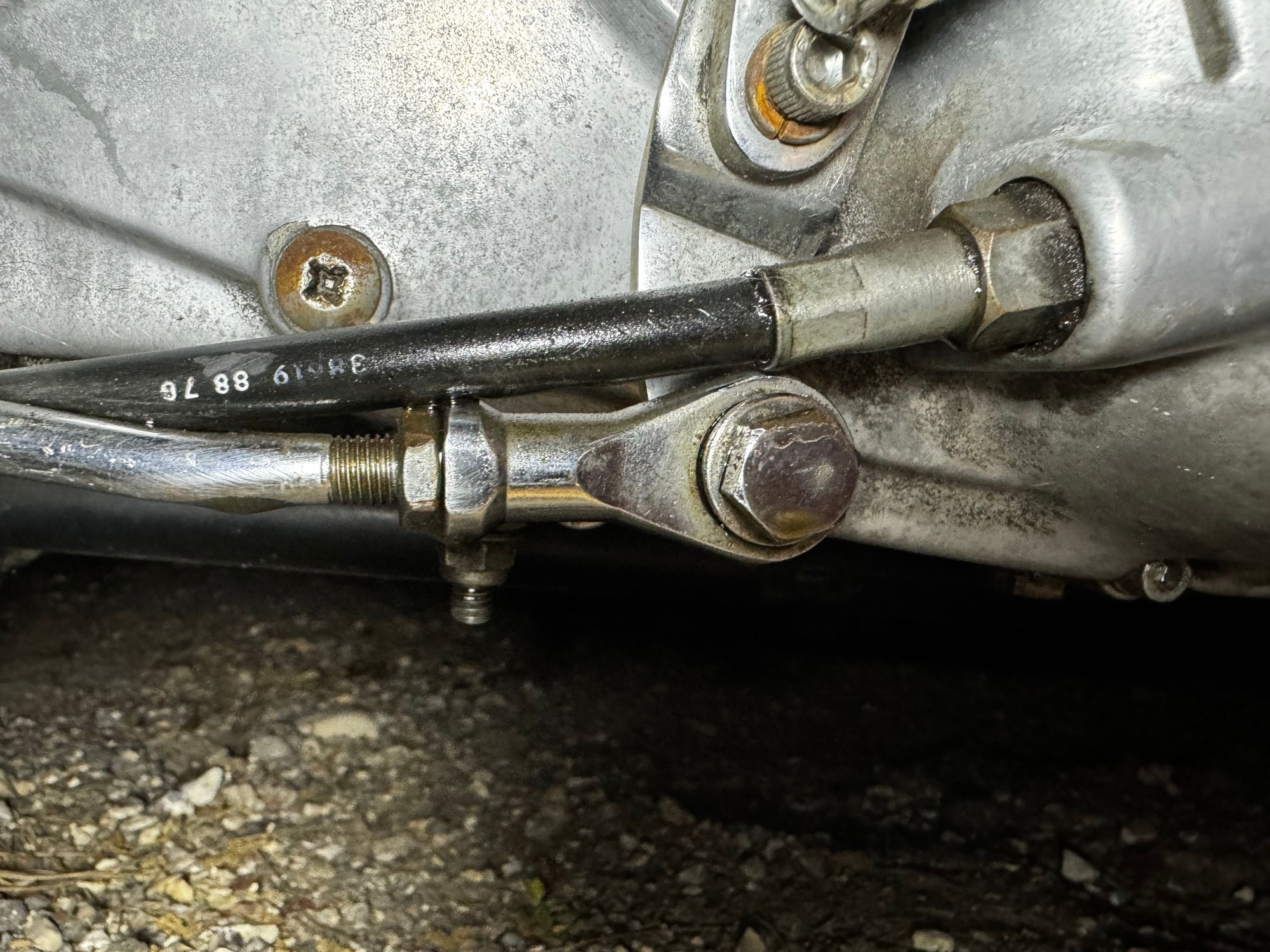

Finally I went for a long ride today, still have some minor issues to attend however, when I parked I noticed a small leak of what I suspect to be transmission/ primary fluid
So I looked online how to check the primary oil level and then I figured I don’t have the right tool to open the cover, it’s the Chevy / bow tie bolt and mine has been forced open several times and a bit worn off.
im looking online for the dedicated tool to open it
the leak appears to be from the bolt connecting the clutch cable to the primary, I tighten it a bit hopefully it won’t leak anymore.
pictures below
Old May 20, 2024 | 09:23 PM
hammer6315's Avatar
hammer6315
Joined: Jan 2010
Posts: 1,266
Likes: 468
From: shore of Gitche Gumee
A 3/8" socket drive will fit your primary cover bowties.
