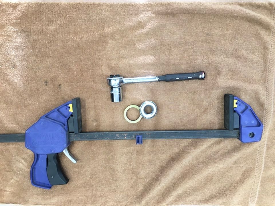

I use a 'repurposed home made tool' for this. It is a large furniture/wood clamp,
a large spacer, and a bearing on top of a socket wrench. Here are some pics....
I did not do this, but for safety, I would recommend securing the lower
part of the clamp so that it won't slip off of the triple tree.
hth,
T.

That's the method I recall seeing, nice work.
