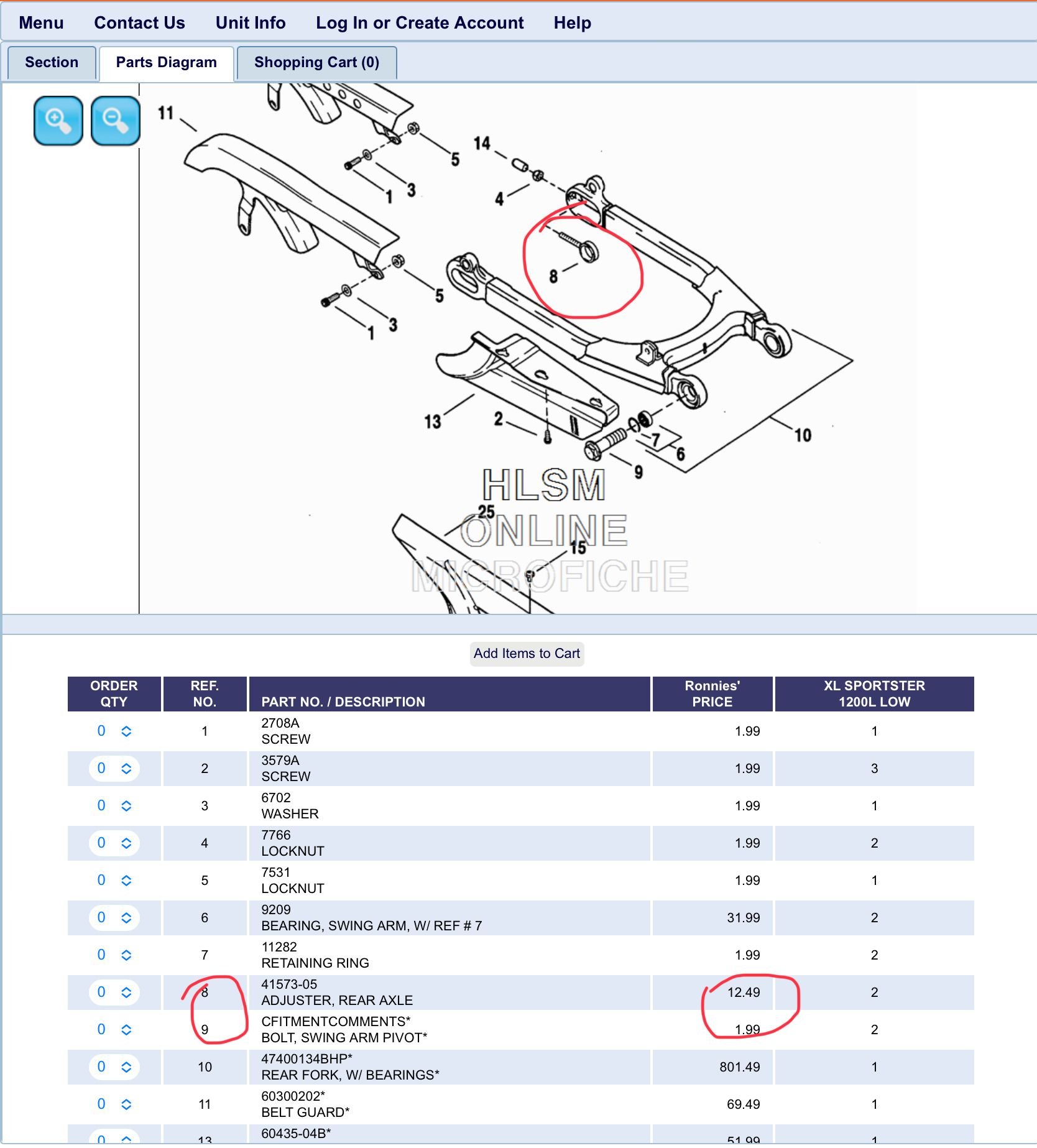

Hello there,
I am new to this forum. I’m coming here because I can’t seem to find any part number or information on my rear axle adjuster. It snapped off due to a poor mom and pop shop probably over Torqueing the rear end. Also, can I ride it to a shop to get it fixes? Any information will help.

Sorry,
It is a 08 sporty 1200 Low
i believe he torqued it to 120 pounds since the adjuster broke once already. I’m no mechanic hence why I’m here but I don’t think he was much of one either
cheers.

Originally Posted by davis0824
I know the part but nobody carries it anymore. Also is it safe to ride to a shop?
available at Ronnie’s
no don’t ride it
dont let anyone near your bike that wants to torque your axle adjuster, let alone 120ft pounds

These have a 5/16-18 thread, there is no way that they should be torqued to 120 foot pounds, it should only be 120 to 180 inch pounds (10 to 15 foot pounds).
The axle nut torque value is 95 to 105 foot pounds and it is 5/8-14 thread.

Thanks for the replies. I appreciate it. Do the rear axle was torqued to 110-120 ft/lbs I believe not the adjuster. But one had broken after taking it to them and now I’m dealing with the same problem. Wondering if I can’t just grab a 5/16 18 bolt from a parts store.
