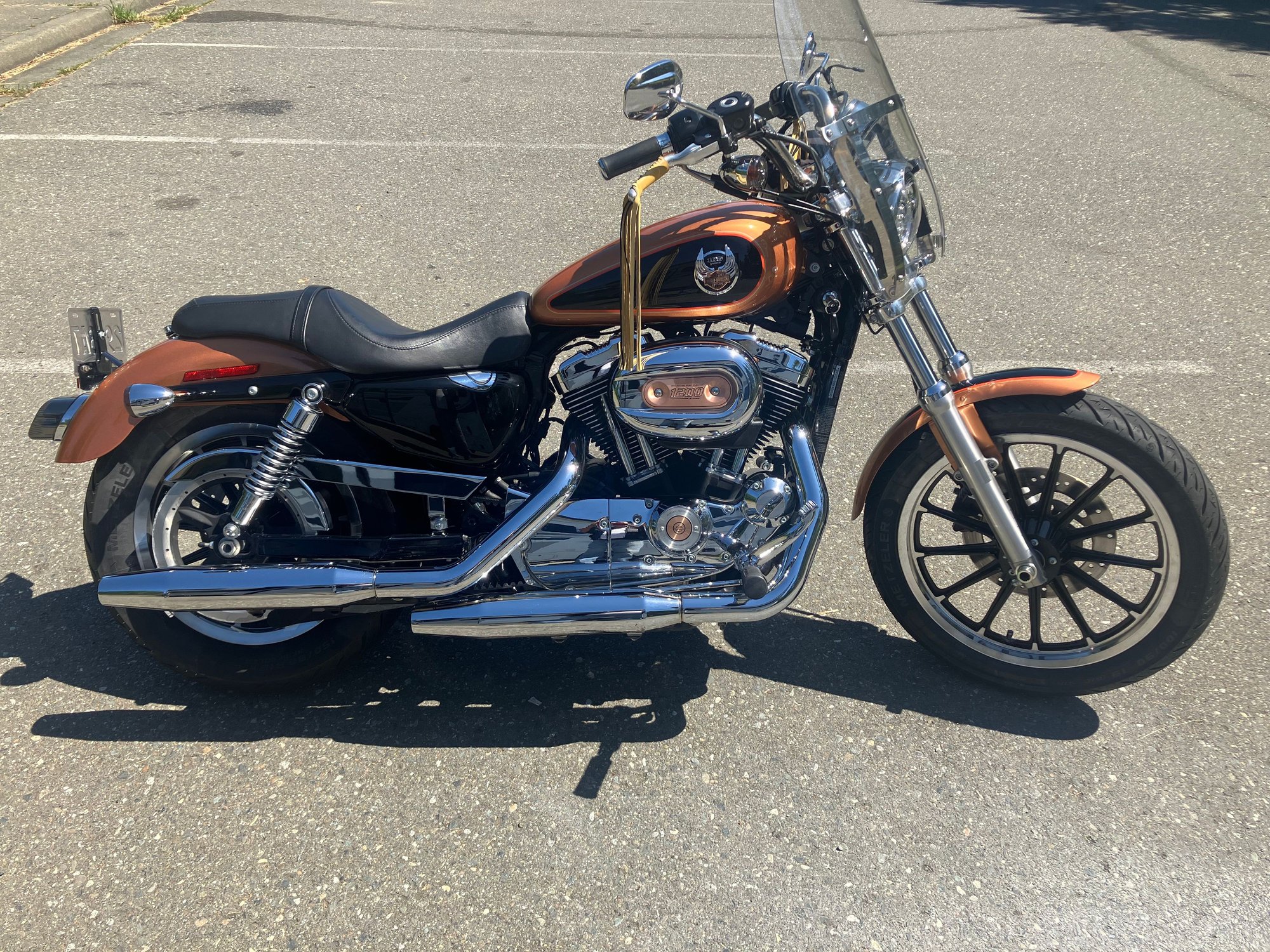

I have a lo and I put in a standard length not low progressive monotube kit in and raised my bike inch and a half. I was going in the same direction as you with the fork extensions but the progressive is a lot better option and you get much better handling. This is after I raised it

I used progressive monotube stock height cartridges simple install and I didn't need to replace the fork seals as they were not leaking or showing any signs of wear. You will like the improvement

Just checked the box and mine were 31-2513
