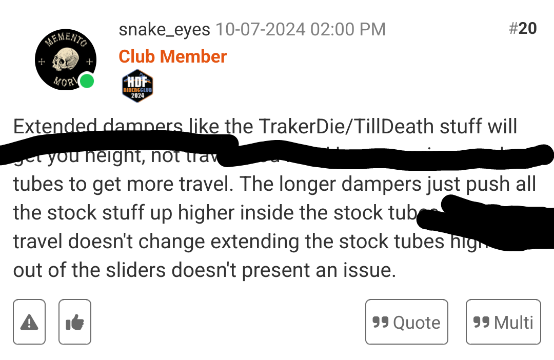

Originally Posted by snake_eyes
Extended dampers like the TrakerDie/TillDeath stuff will get you height, not travel. You need longer springs and tubes to get more travel. The longer dampers just push all the stock stuff up higher inside the stock tubes. Since travel doesn't change extending the stock tubes higher out of the sliders doesn't present an issue.
This is just wrong and backwards
Longer dampers increase the amount of volume between the bottom of the slider and bottom of the upper tube, increasing travel.
Longer tubes or springs gives you height, not travel.

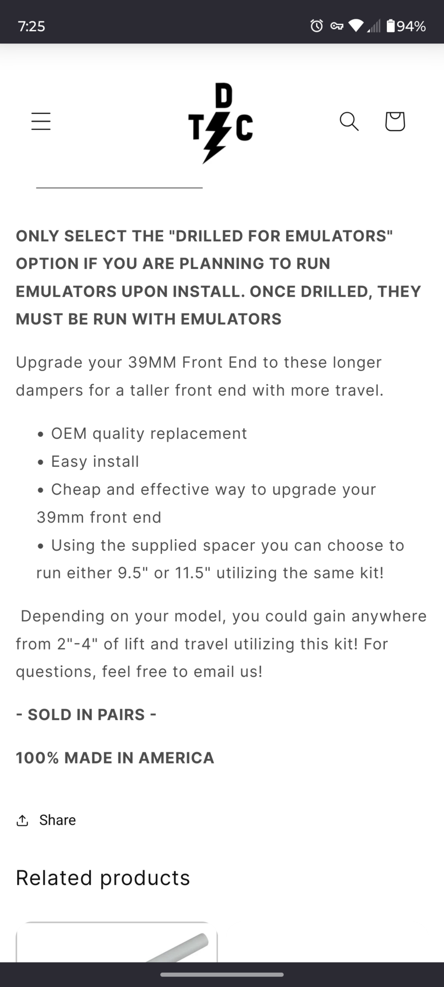

No it does not. It increase the volume in THE LOWER SLIDER. Not the upper tube. Go back and look at the pictures weekends posted. It doesn't "push" anything upwards. It pushes the lower slider downwards.
The springs do not dictate how much travel you have.. Increasing the length of them also increases height/travel. In this case also increasing travel.

"No it does not" is not an explanation of where the extra travel comes from. Additionally, you quote me as saying "push" and I said no such thing. I said the components of the fork are "moved" higher in the leg. I think you need to do some reading on how the mechanics of the design work. Adding fluid volume in the slider by itself is not going to add travel, the spring would also need to be extended. The fluid in the slider provides damping and rebound as it pushes against the air gap in the tube, nothing more. As I said before, every component is moved higher by the extended damper and the air gap doesn't change. I went through this whole process a couple of years back and learned a ton from the experts here on the forum, read through this and you'll learn a lot. See here Performance Fork Rebuild - Harley Davidson Forums (hdforums.com) and here Fork Oil Level - Harley Davidson Forums (hdforums.com)Take a look at the picture below from RaceTech (ignore the Emulator) and it'll help you understand.
And finally, in regard to the screen shot you posted, just because some sales guy tells you something, it doesn't make it true. You should call and ask them to explain how travel is increased and let us all know.
