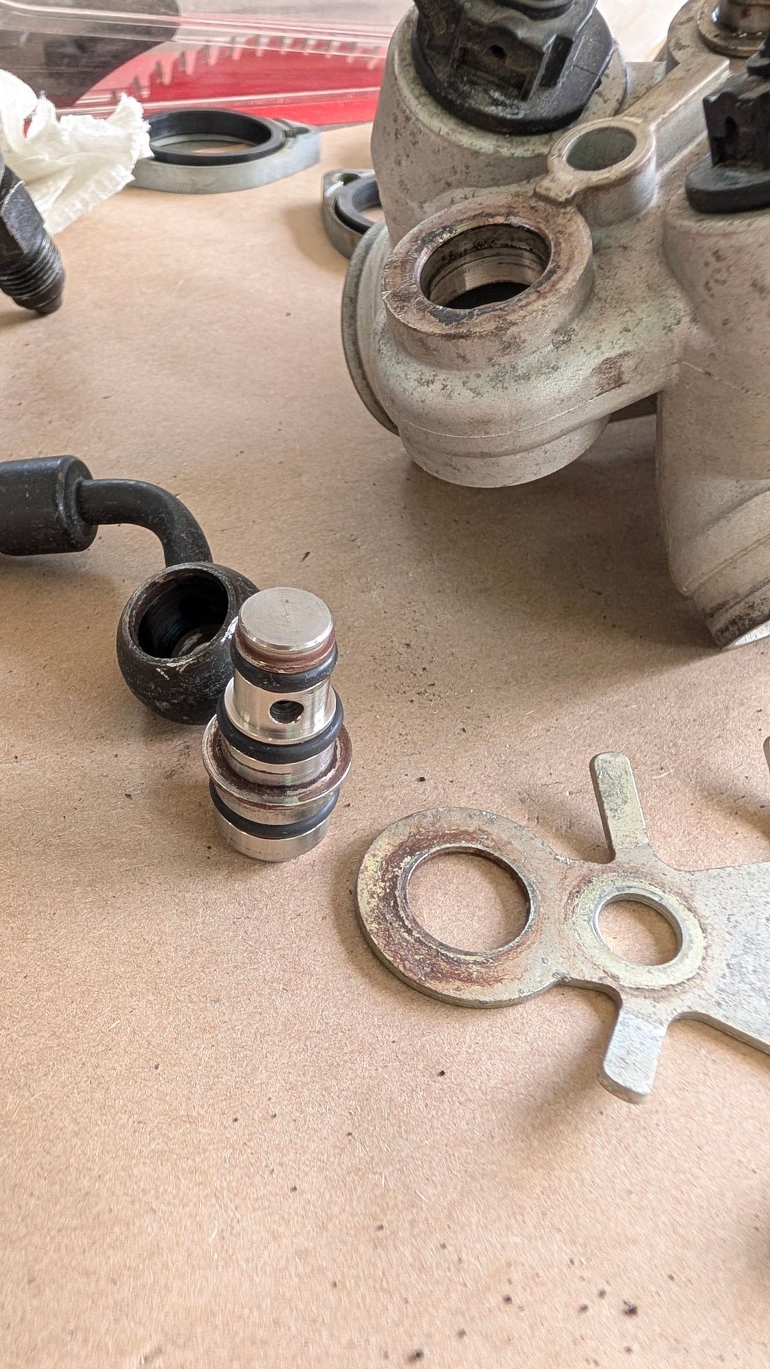

I was finally able to get this out!! Whew.
NOW TO BUSINESS: should I be concerned that the rear fuel injection line is rusty? I cleaned up the parts a little bit already.
