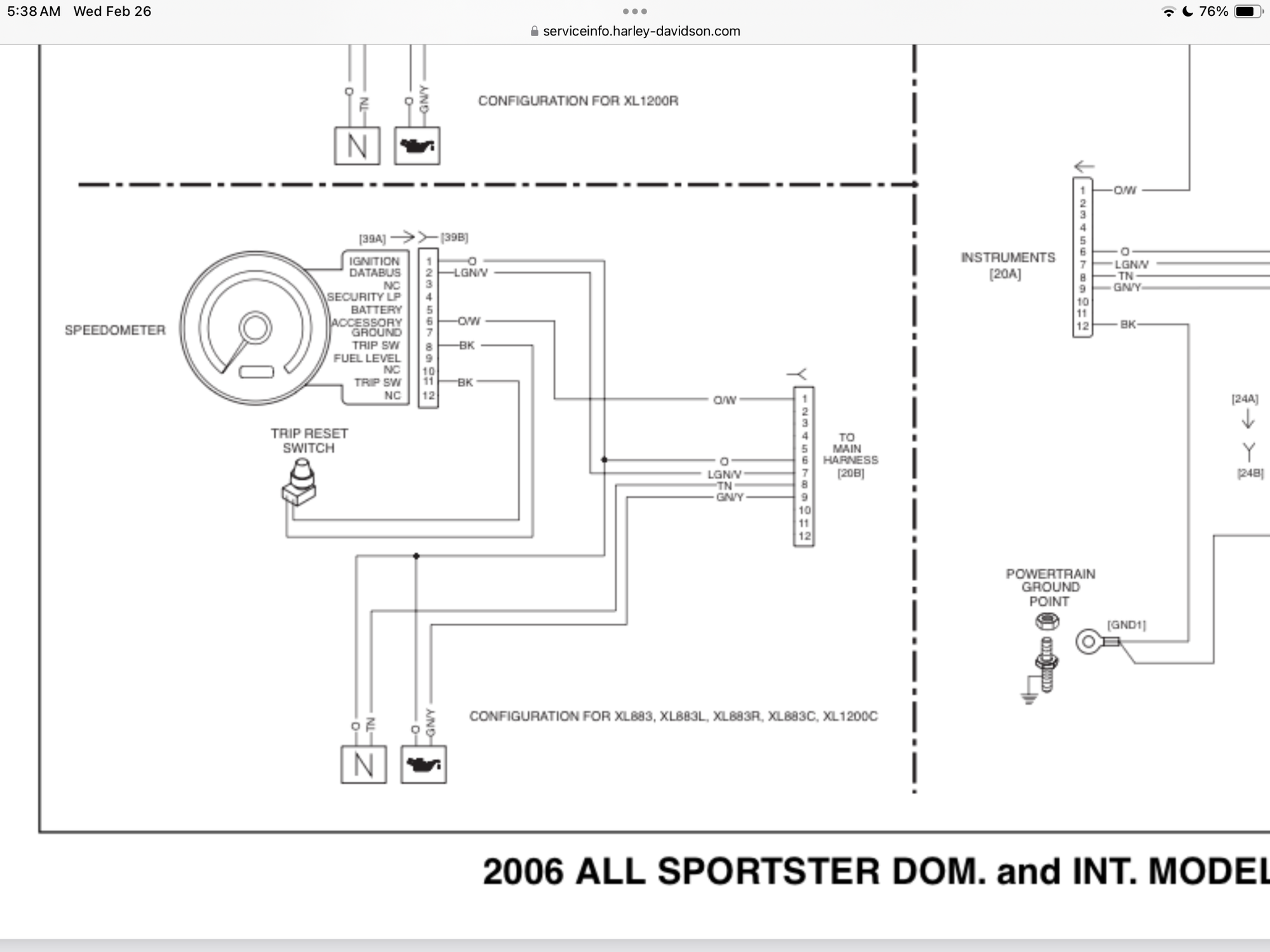

I’d start here - https://serviceinfo.harley-davidson..../document/5533
Doesn’t look too bad-
good luck
