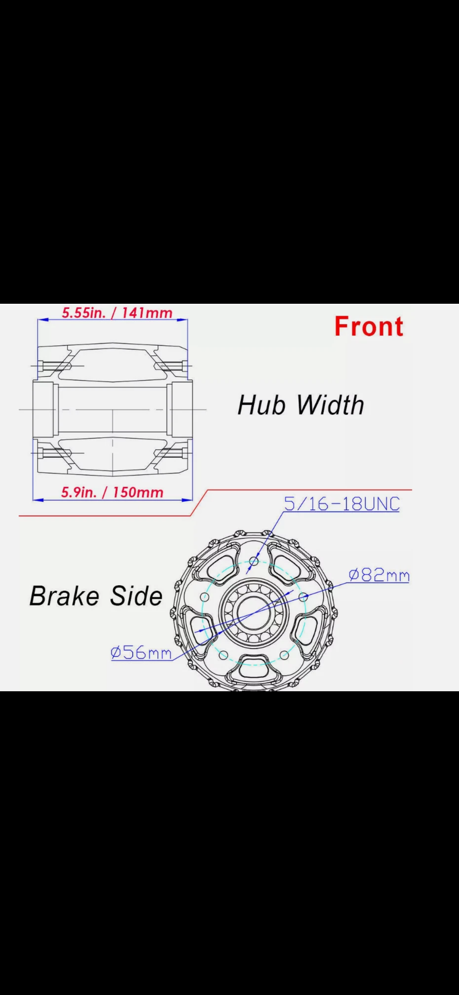

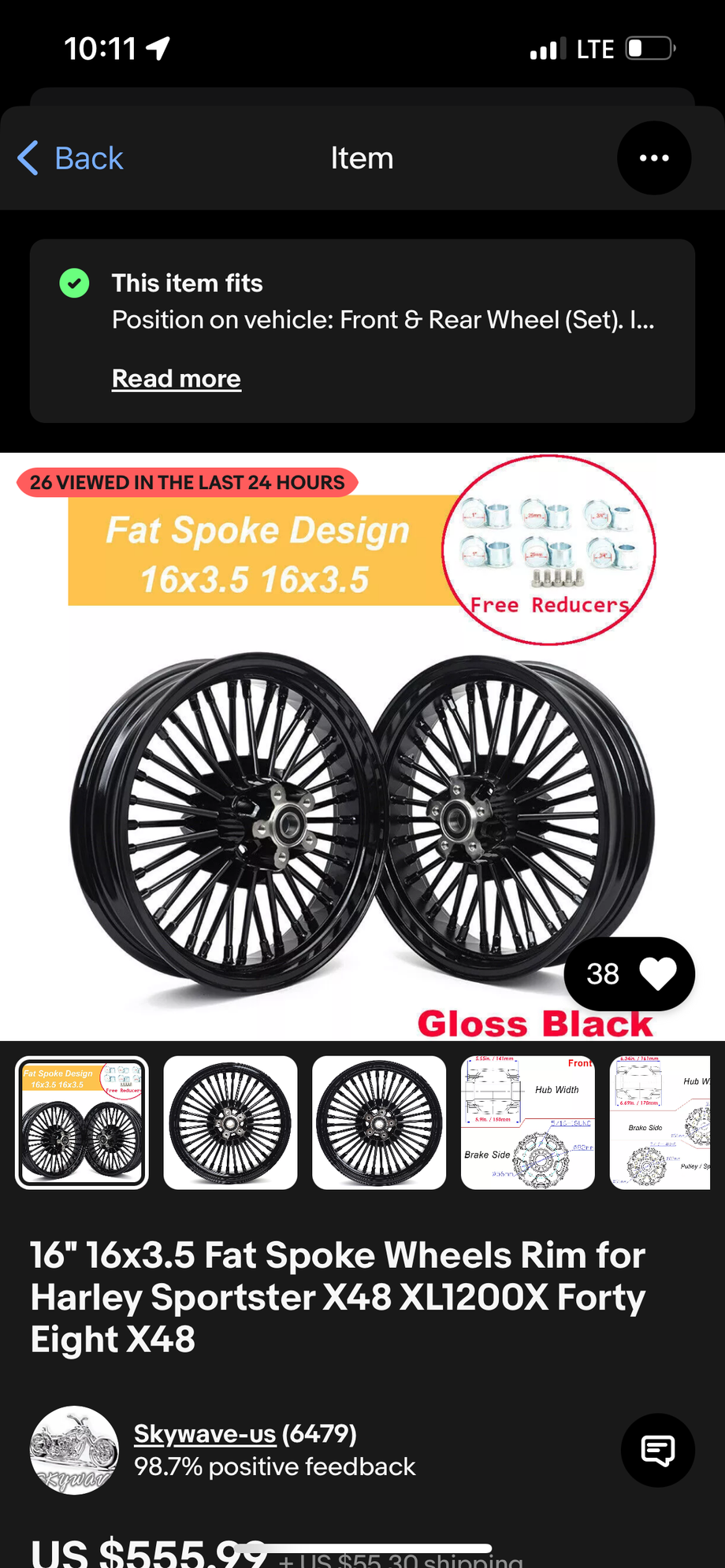

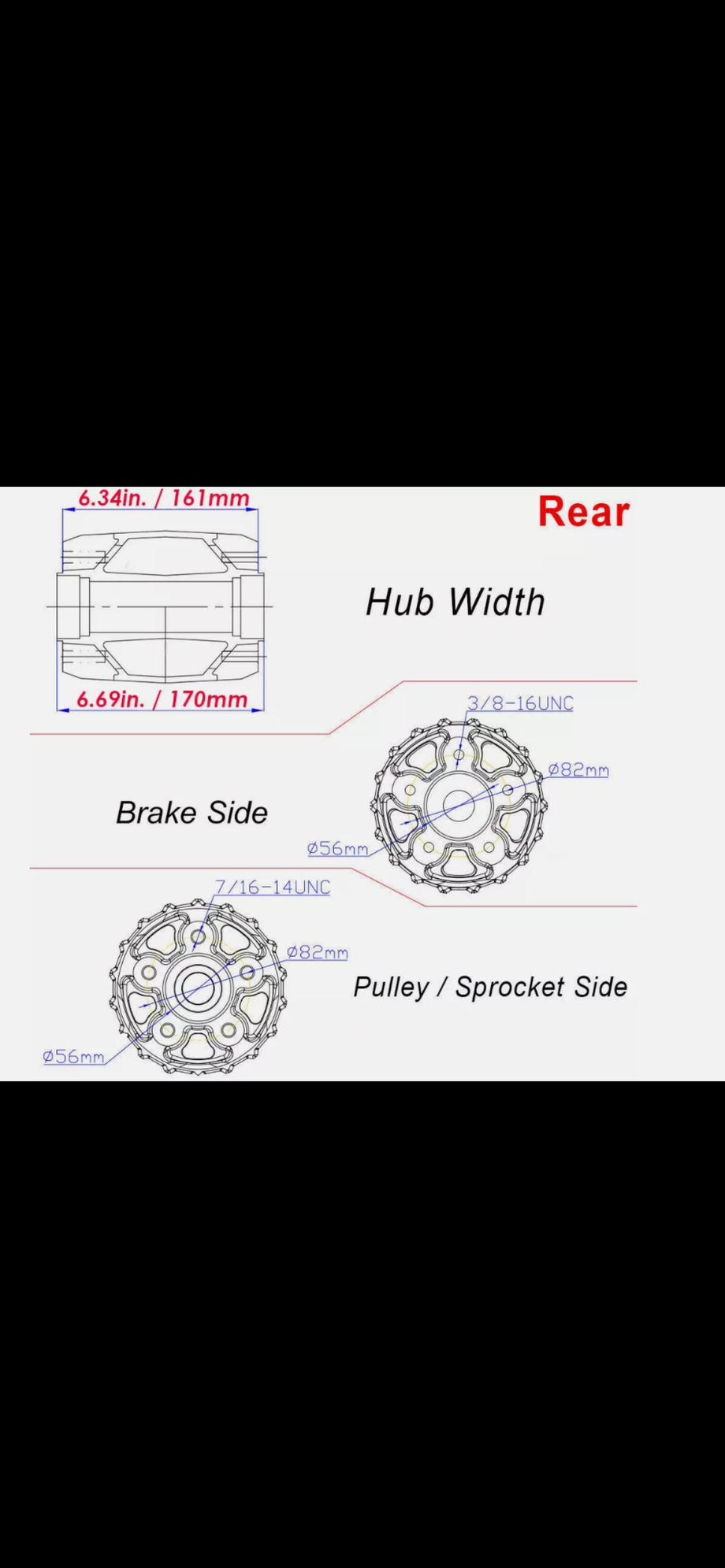

Anyone here can help me figure out the wheel hub dimensions on my 2011 sporty 48 I need to know the width. Found a 36 fat spokes 16x3 on eBay. Just wanna confirm before I purchase. Ad claims that it would fit my year and model. I have attached their blueprint
feed back would be greatly appreciated
