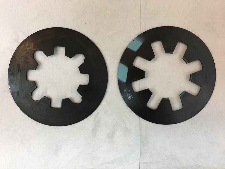

I do see that the E1 spring has half round cut outs on the root ends of 4 of the spring fingers. The H-D are all squared off. I have no idea if that makes a difference or not, but they did go to the trouble to make them that way. I doubt it was a patent infringement issue. Perhaps TC over on XLF was correct.

I read over on XLF that the Energy One diaphragm spring is a better design than the H-D and allows an easier pull. The guy over on XLF is pretty savvy, but he did not post up any photos to show what the differences were between the E1 and the H-D springs.
John
Here's a picture I took when I changed my 883 clutch to an Energy One clutch with 15% stronger spring
hth,
T.
