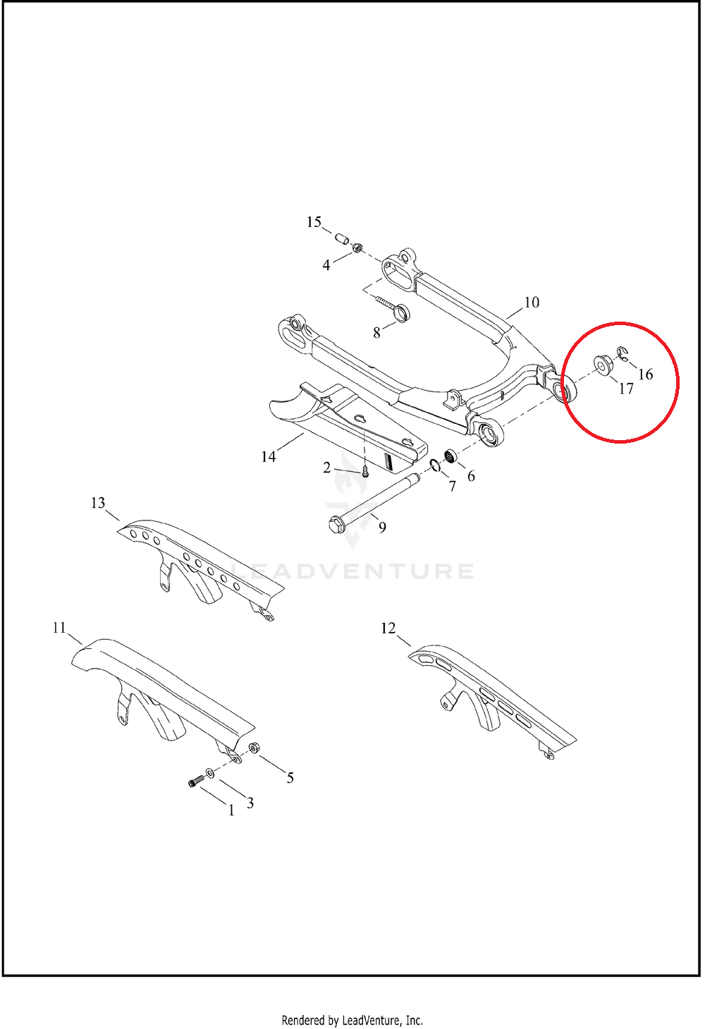

I've searched and searched with no luck, so I'll ask away and brace for the answers. Got a 2021 883 Iron missing the swingarm pit bolt nut.
Dealer has them on backorder until Feb. 2026, bike is currently a non-runner (project) and I'd rather not have to pull the swingarm bolt to carry to a hardware store. Does anyone know off hand the thread on the bolt? I've searched way too much, MoCo does not list and $20+ on eBay for a nut is a bit of a tough pill to swallow. Thanks for any assistance!

The part number is 47500006. It appears
to be a common axle nut used on alot of different bikes since 2014.
There is one listed on Ebay for $13.00
https://www.ebay.com/itm/176866162851
Looking at RonniesHD microfiche, that nut should cost $4.50...
You might try going to a different dealer or have
them search for it at another dealer and transfer it
so they can sell it to you.
hth,
T.
Ref:17
47500006
PIVOT NUT,SWINGARM
Price: $4.57
Harley website says sold out but some dealers in my local area (Harrisburg, PA) have them. Like stated above, have your dealer do a search and have one shipped to you.
Website says Crossroads HD has them.
Available
Crossroads Harley-Davidson
1921B Hwy 421 Business, Wilkesboro, NC, USA

The bearing (but not really a bearing) that is in the swing arm hasn't changed over the years so I can quite confidently say you need a 3/4" UNC flange nut, something like this:-
3/4"-10 UNC Flange Nut Northwestern #34fn - R. E. Glover Ltd.

For future reference of others, the nut is a 3/4"-16 flange nut. Such an ordeal to figure out, I thought I'd put it in the interwebs for others.
