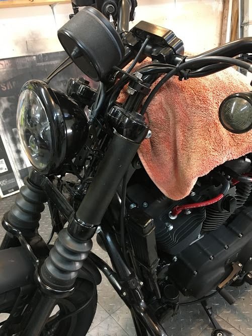

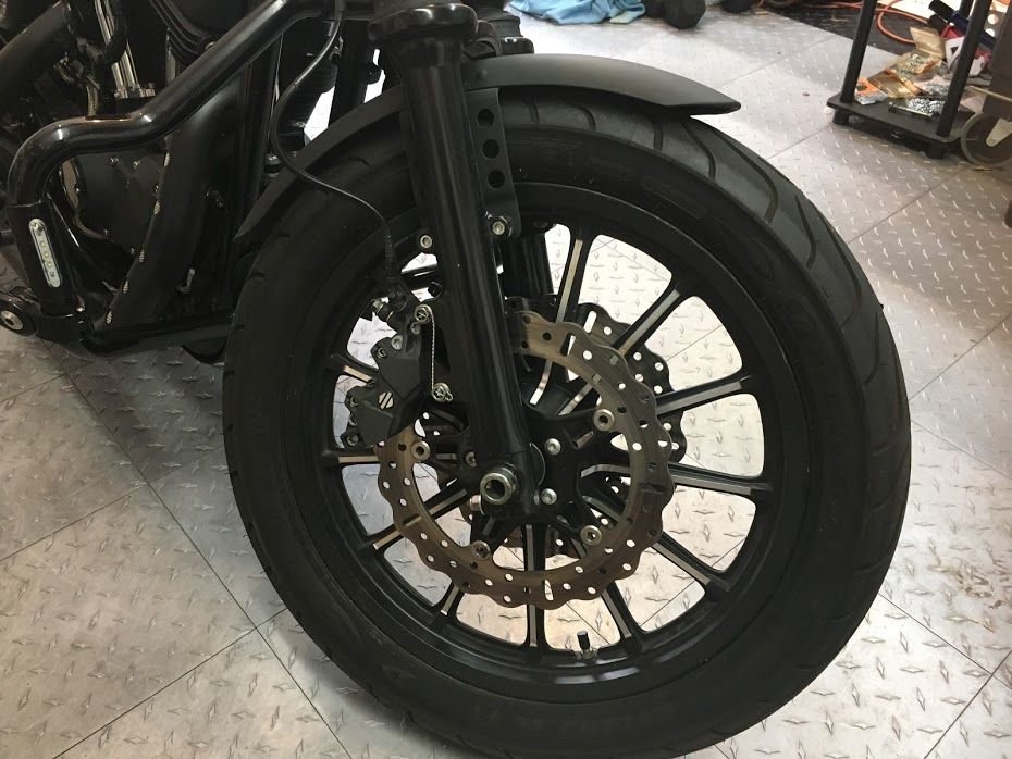

I have not ordered anything like that from AliExpress, but I did
use a pull back riser from Drag Specialties that is very similar to
the one shown. What you will find is that if you are using the
stock 3.3gal Iron tank, that a 3.5" pullback riser will hit the tank.
You will need a 4.5" pullback riser to clear the tank. I suspect that
the amount of rise needed would be even greater if you have
installed a "tank lift" kit...
Here is a few picture of mine, no tank lift, 4.5" pullback riser.
The pics do not show how close the tank is to the clamp, but
at least will give you an idea of the pullback...
hth,
T.

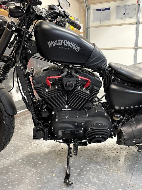

Yes except for the brake line. I felt it was too tight even after I bent
the stock hardline some. If I remember correctly, I might have had
to reroute the control wires, but since this was done over ten years ago, I
do not remember exactly. I just found another picture that somewhat
shows the tight clearance with the 4.5" pull back riser.
On the brake line, at the time I was also converting to twin discs,
so I replaced all of the brake lines with black stainless lines.
I was also planning a longer damper tube swap, so I installed
longer lines. Here is an older picture.
Good luck & hth,
T.
