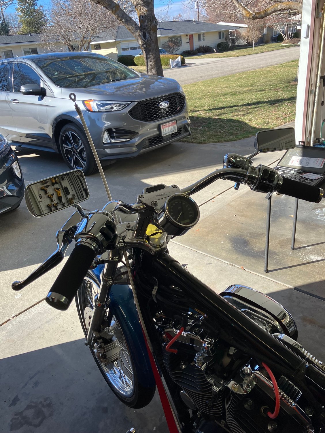

This was last weekends job, new handlebars chrome controls and internal wiring. I must be getting slower in my older age took me about 8 hours.
Hopefully the new cables I ordered will get here before the weekend and I can install them alone with servicing the the primary and can do the final install on the carburetor and breather system.

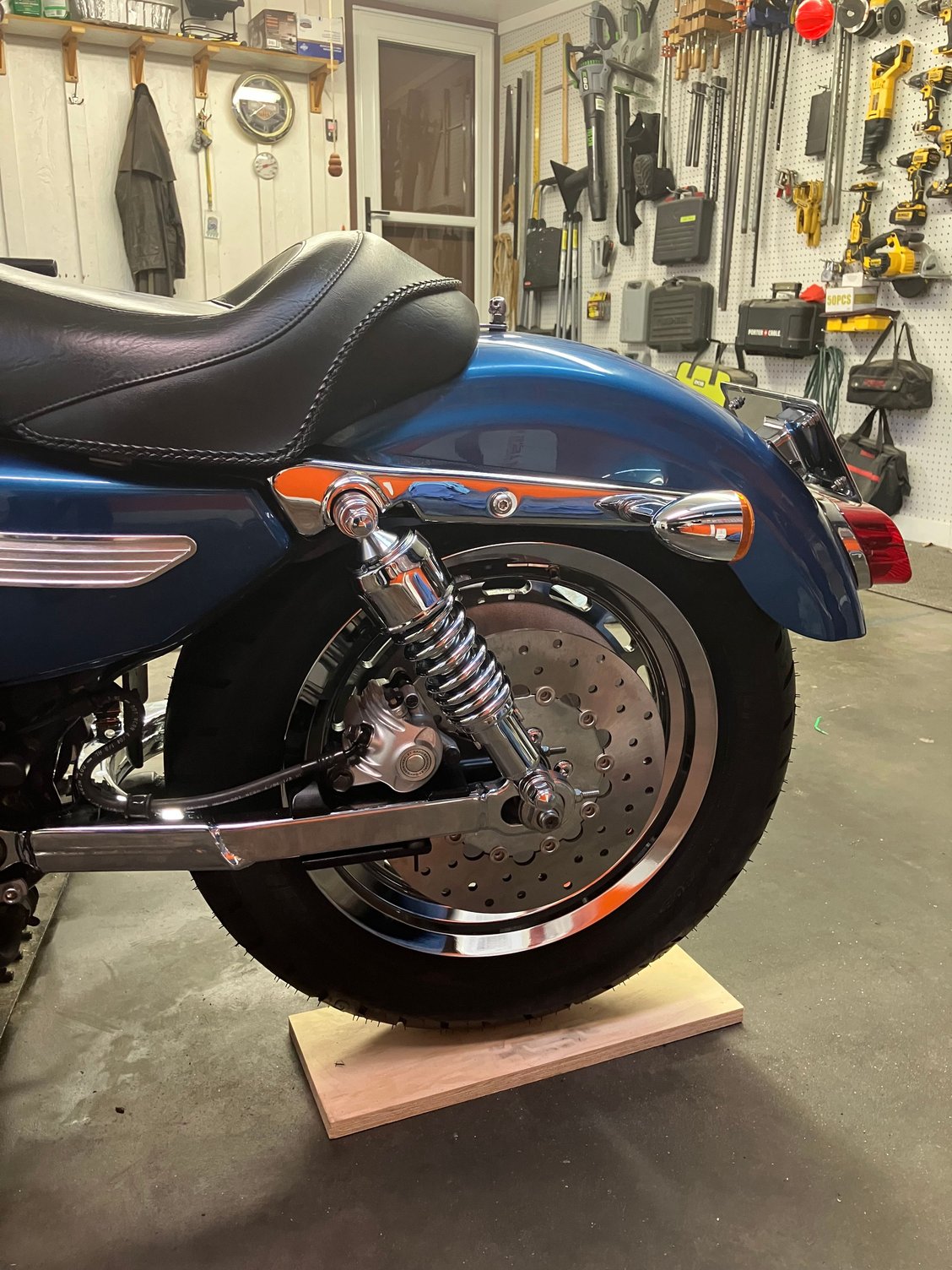

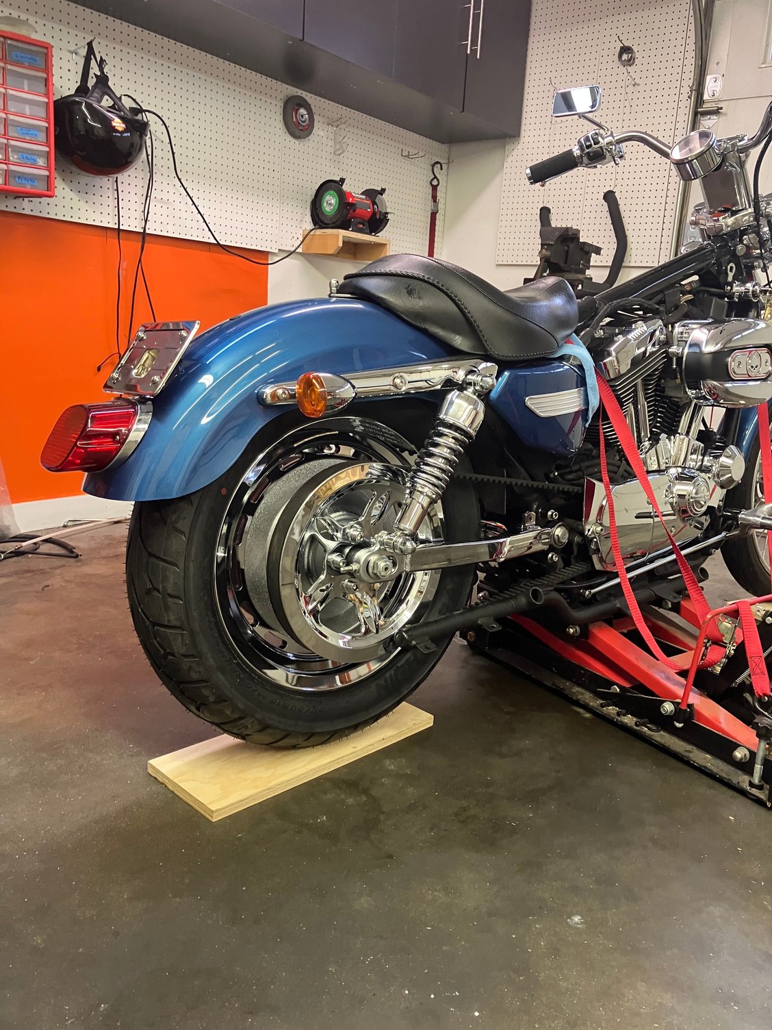

This weekends projects Saturday was a total waste of time almost nothing fit properly so I spent 1/2 the day taking parts out to ship back so I could get the right parts on the way.
Sunday was a good day everything went perfect, got new swing arm, rim, sprocket cover, taillight and licence plate bracket installed.

Also installed new brake rotor, brake pads and the new shocks.
The picture makes the exhaust crossover appear to be very close to that new sprocket cover.
Could just be the angle of the photo, but how much clearance is there ?
Thanks,
T.

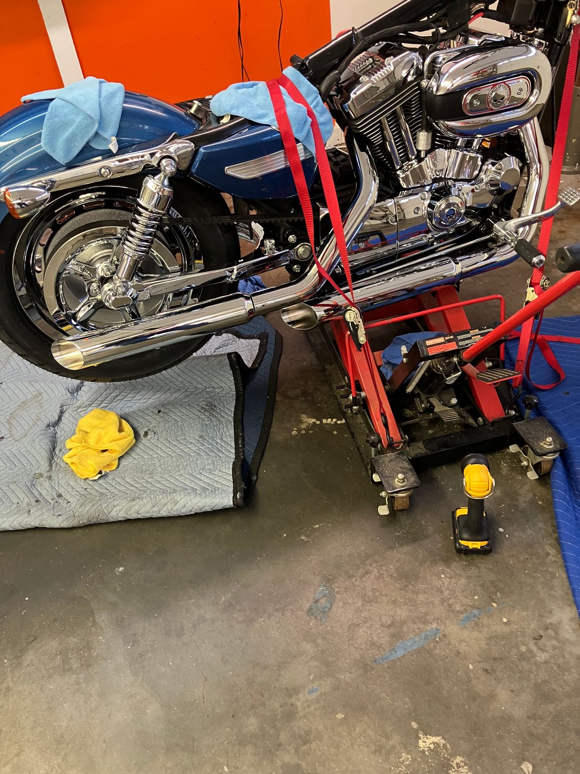

Last weekend I got the exhaust system put back on with a new old set of Rush mufflers I found on EBay.

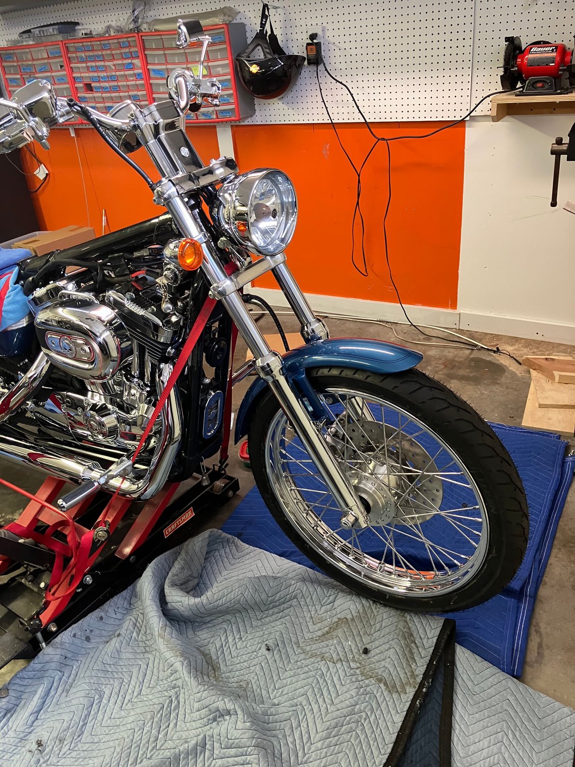

This weekend I got the front end rebuilt new chrome lowers, progressive springs, new oil, new seals, new tire, got the clutch and throttle cables installed, also got the primary lube changed and adjusted the primary chain.

Also got new brakes and front rotor
Wow, look how shiny the inside of those mufflers are! Cool.
