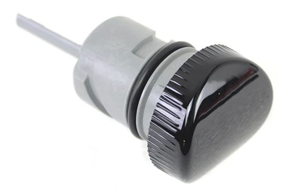

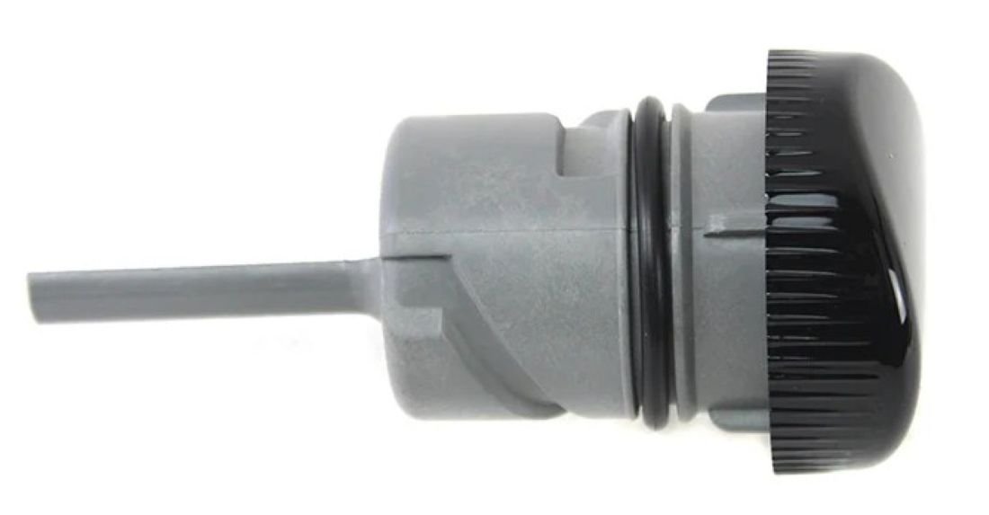

This is one of the pop-up dipsticks for 2004 to 2022 Sportster models.
I think I saw a fix where people were replacing the o ring with a thinner one. Rdhigh also posted a good tip above to lube the o ring and grooves.

I dunno, mine comes right out. (2014)
I did wipe the O ring and grooves with a little motor oil once. The pop up/down deal is just for looks to make the cap flush with the tank. The actual stopper doesn't move.
