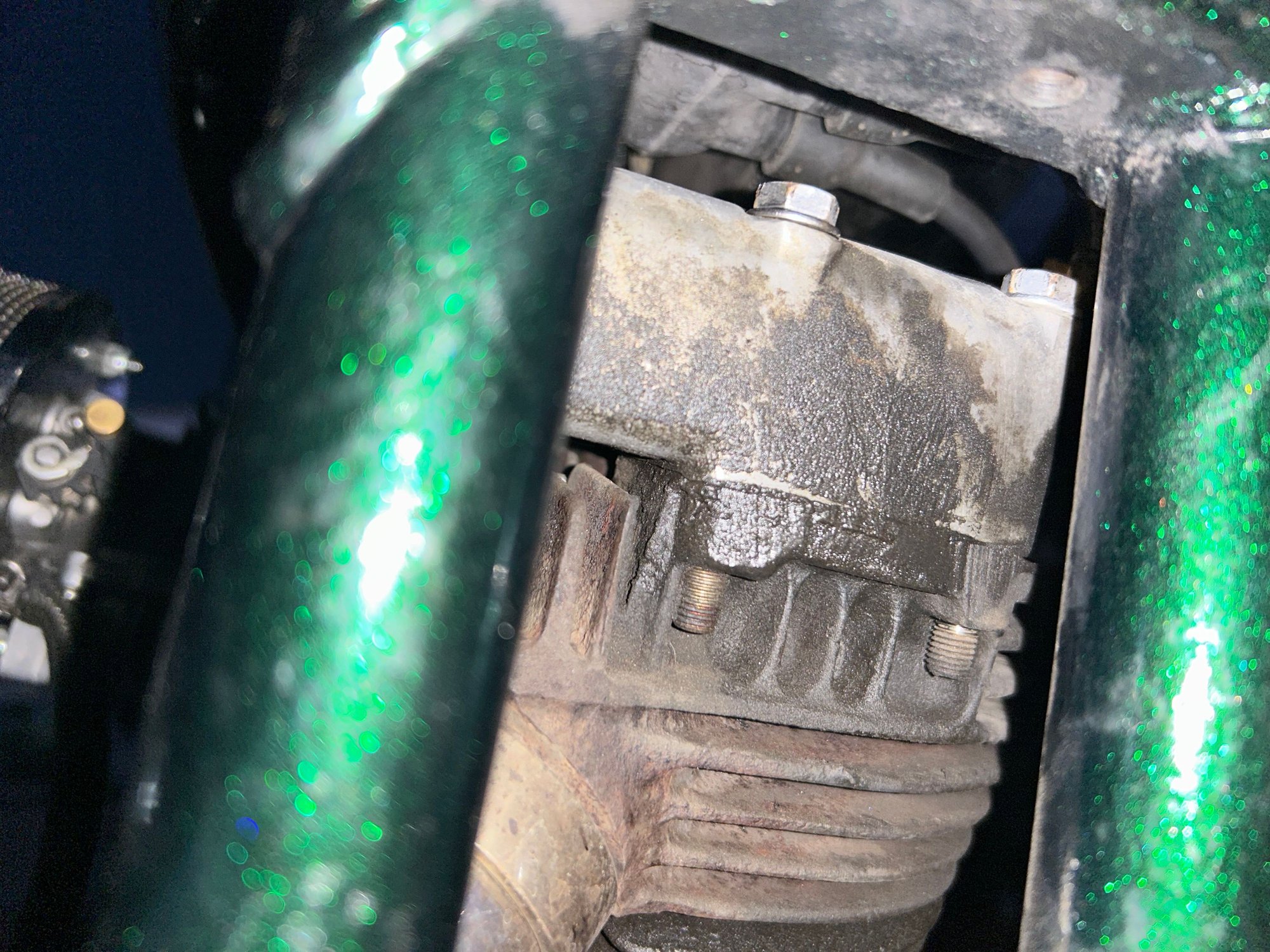

I have a 82 iron head , the front rocker box is leaking and causing the oil to burn and smoke while riding , I replaced the gasket and still smoking and leaking. Do I have to machine the rocker box ?

Fine grit emery paper laying on a perfectly level surface. Start hand lapping rocker box to clean up imperfections. Looking at that cylinder and head, ya might wanna do the same on them.

Is the bolt shanked out? Try adding an additional washer under the bolt head. *Edit* Or a shorter bolt, those look about 8 threads too long.
