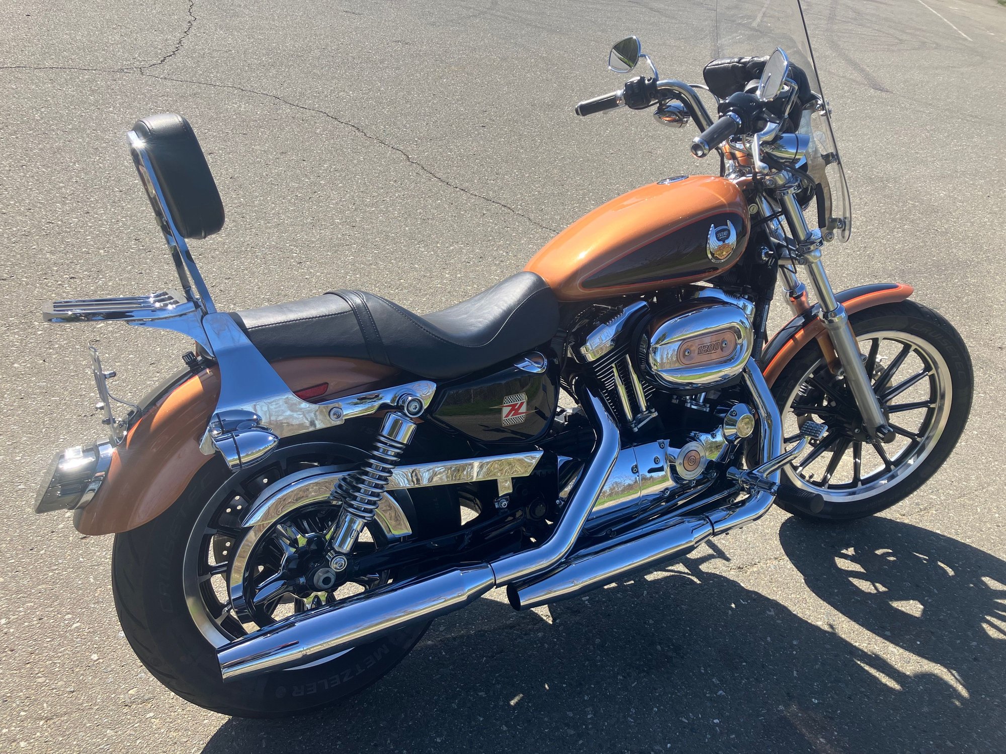

I picked up a set of mufflers from a 2019 sportster custom and was hoping that they would fit my 2008 lo. Anyone with experience with this please share. Thanks John

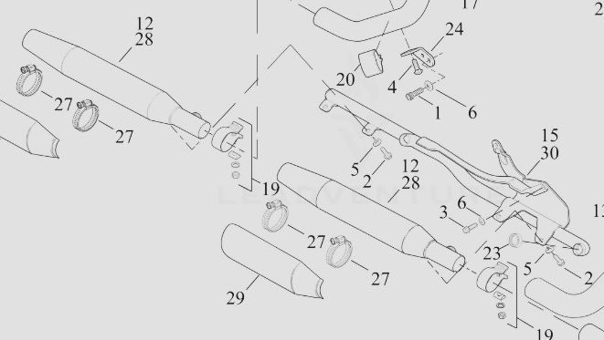

You have 2 basic problems. Those mufflers don't have the balance pipe ports and secondly the o2 sensor ports are a smaller diameter than on your bike.
To make them work you would need the brackets from the newer bike and a way to fit 18mm o2 sensors in a 12mm hole.

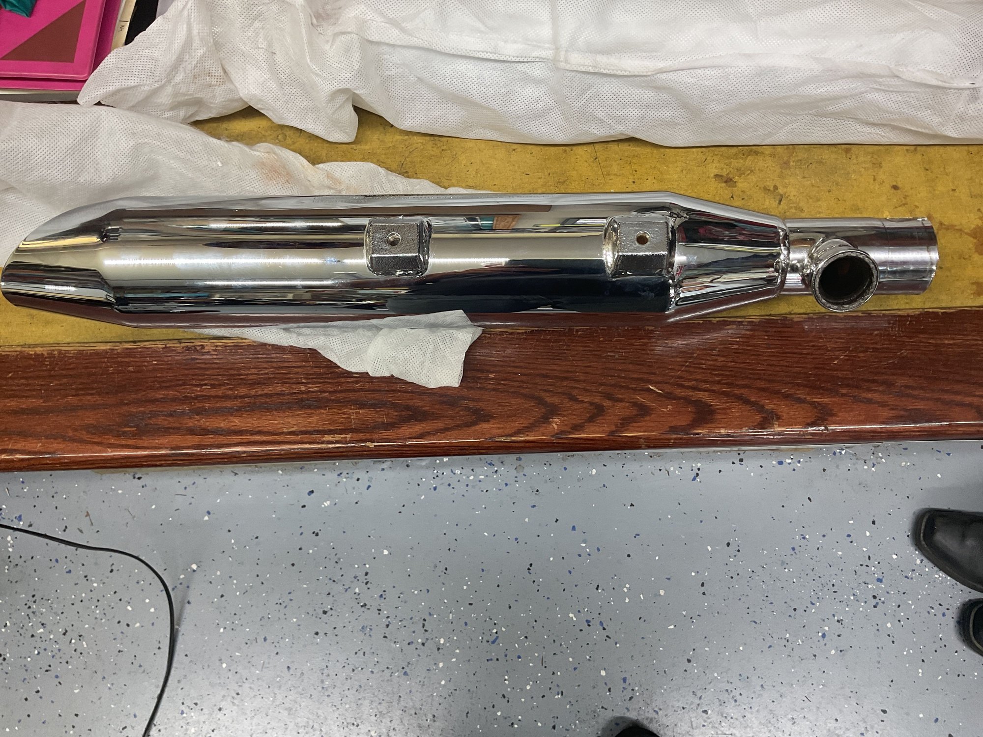

They do have the ports and I’m only wanting to change the slip ons

If they have ports then they are not from a 2019 bike which is very good news for you as they ought to fit on your bike if the rest of the exhaust system is stock.
I did make a stupid mistake as the O2 sensors are in the headers. So apologies for that.
I hope you can see here on the 2019 there is no ports but you can see on a 2009 they are there:-
2019
2008

Actually the fellow I purchased them from didn’t seem too sure maybe guessed, but to me they looked correct. Not too bad of a project. Thanks for the advice
