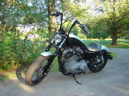

Here is a pic of a sporty with 14" apes that I found on apehangers.org. I have mini-apes shown in the 2nd pic and love them
