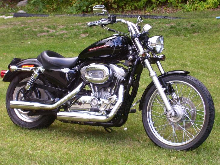

You can use the configuration found on a 1200 Low for chrome or an 883 Low, Nightster or Iron for black. I think the stubby risers look great with apes. If you do, there are some little bits you need to swap the dummy lights.
Pic of 1200L:
From:
https://www.hdforums.com/forum/sport...00-custom.html
#2325 Screw 2x1.99=$4.00
#2361 Screw 2x.99=$2.00
#68513-95 Bezel warning lamp housing 1x2.99=$3.00
#68516-95 Housing, warning lamps 1x11.99=$12.00
#68551-95 Warning Jewel 1x18.99=$19.00-->Almost crapped myself, this is the little colored lens.
Look here for pics:
https://www.hdforums.com/forum/membe...-ape-pics.html
