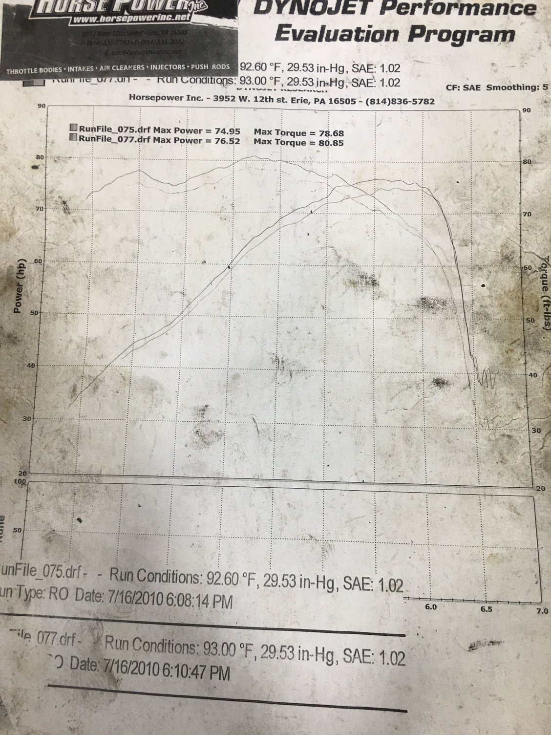

Default 1991 sportster 883 to 1200 conversion shrink ported
First time on a dyno later I found I was running about 13,5 to 1 Fuel air ratio
it was still duel fire at that time my MAC dial back timing light would not work correctly with it I timed it by ear I was in the 42-45 degree range
When I went single fire with a crane HI4 module it liked the multi spark setting along with 30 degrees advance then at 12:1 F.A.R it came alive sorry never went back to the Dyno bot seat of the pants it was better
I shrink ported the heads running 1200 size tulip valves with 10:1 wisco pistions with sportster sport cams

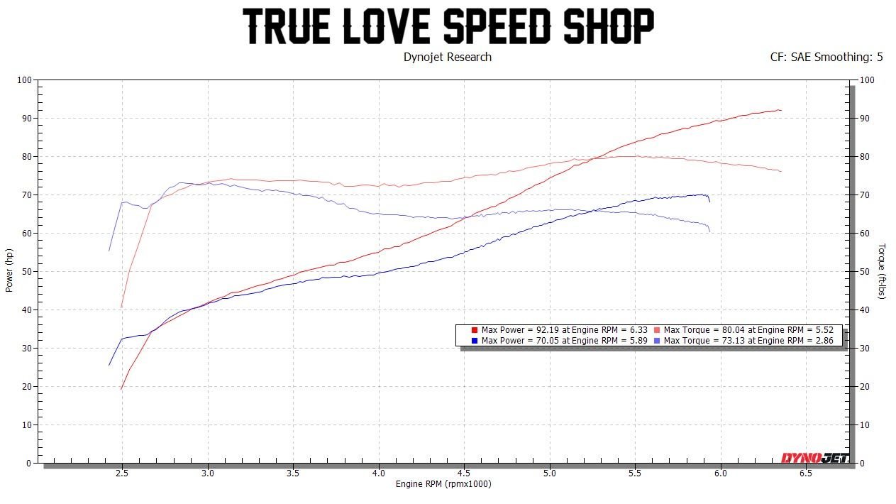

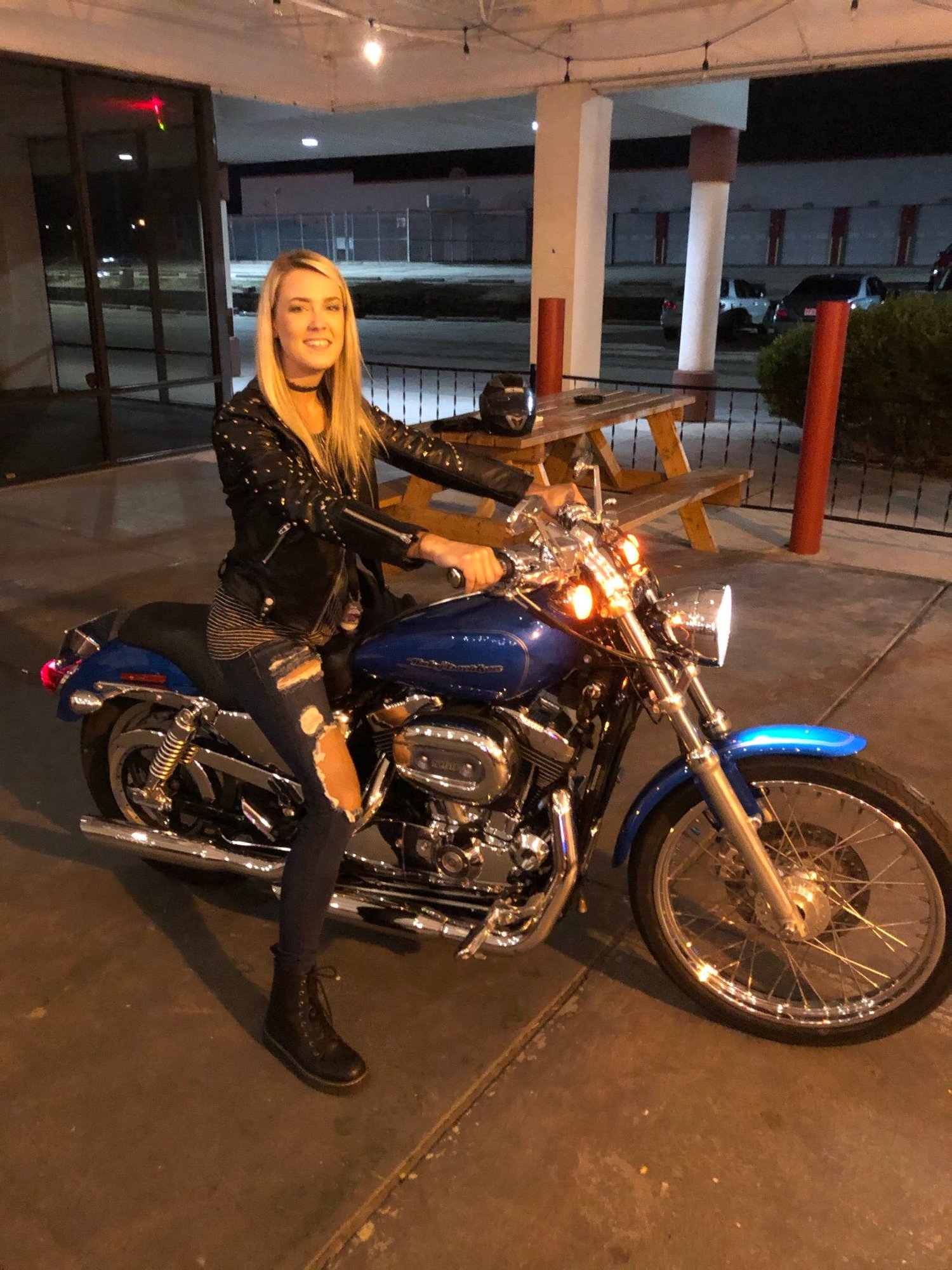

Default Daughter’s 06 1200 Custom
Before & after.
S&S performance AC with stock cover
Performance ignition
re-jet factory carb
+.0.20 10.5-1 pistons
Performance valve job bee hive springs
Heads milled for quench/10.7-1 comp
Andrews N_ midrange cams. I’ll have to get #
Vintage SE pipes with lollipop inserts for torque
Good power to weight it beats 9 of 10 big HDs

9 out of 10 and they're getting beat by a chick, hard not to like that one

nice! It’s still making powa!

Pull it to 7k!!!!!!!
