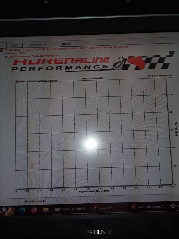

From: Phoenix
67,000 Mile, Turbo Buell PSiclone on 9psi boost, pump 91 - 106whp! Wasn't even a full dyno tune session, just a few pulls with 1 minor adjustment. There's 10whp left in the tuneup without a doubt, on the same boost level. As a reminder - 1998 Buell M2's did NOT have Thunderstorm heads, M2's didn't get them until 1999. The M2's also still had D cams; other than a smaller 62cc combustion chamber, the heads are the same as every other 90's sportster 1200. They are 10:1 vs. 9:1 compression, but that has to be offset by running a more gentle ignition curve on pump gas, so it ends up being a wash IMO.
If you look closely, you can see there's a stumble around 5,500 - it was the adjustable power jet we are using adding too much fuel - the AFR's went into the low 10's, and settled at mid to high 10's, which is obviously wayyy too rich. This is why the power takes a dive at that point. We were testing an alternate Powerjet supplied by a company that said there's was better than the one on our sportster kit; that was not the case. This bike will be getting the better powerjet installed, which will cure this really fat spot - and probably have it crest 110-115whp......on what is essentially a 90's sportster motor!

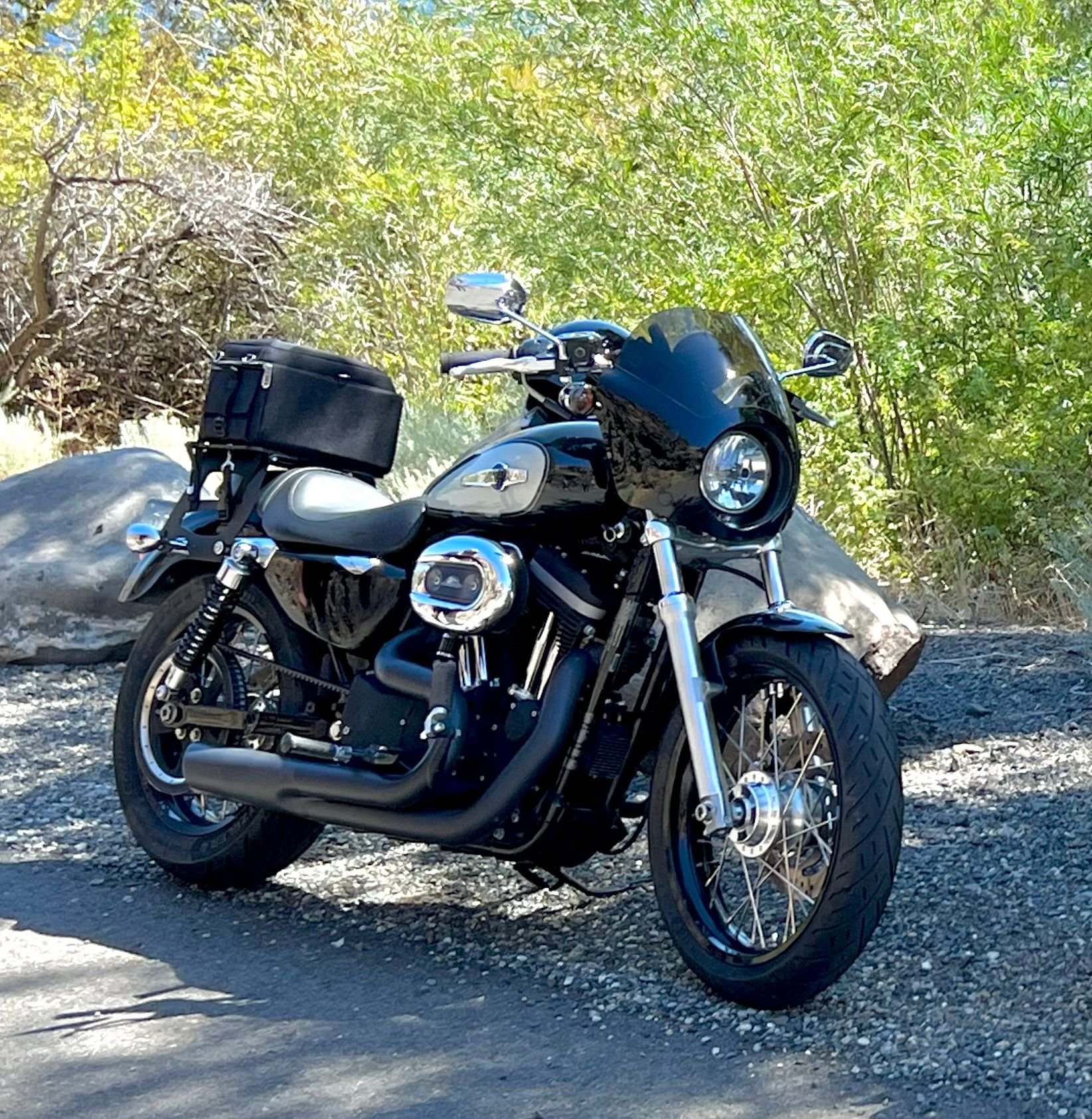

Maxacceleration's Avatar
Maxacceleration
Joined: Oct 2022
Posts: 144
Likes: 195
From: PNW
Here is my aging dyno sheet. For my bought new '13 Custom. ...Hammer work done in '13. I had an odd mix of parts, where maybe I could of done better for improved numbers.
But its very strong as is. NRHS Stage I heads 10.2:1 compression (stock pistons), N4 cams, Hammer intake, Patriot Defender exhaust which IMO make the whole thing work well. Well regarded header. Heads are key too.
Couldn't quite get to 100 hp and the stock clutch is worn & losing grab atm. Its does run like a champ though ...right now. ;-)
I shoulda gone all Hammer, but it was early in my knowledge base.
Looking maybe to up the power again...
