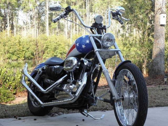

Got Paugcho upswept pipes with fishtails installed on my bike about 2 months ago, and they are loud...

No crossover and they look like they're 2" also,must be loud. They look good, you h ave a good theme there. Stars,stripes,pipes.

These pipes will only work on '03 and before bikes because they changed the heads(I believe), what I had to do was cut the pipes coming off of the head, and cut the new exhaust, match everything up, and weld them together, I had it welded where the heat sheild will cover the weld. Of course if u look close u can see the weld, anyway, I like the look...

Primo, your bottom pipe looks low.does it have a hole yet,you may have to get your welder out and maybe just put a little patch on there to beef it up, use an old piece of heat shield.That long front end is super cool, did you tweak the back bone at all to balance it out? Peter Fonda
