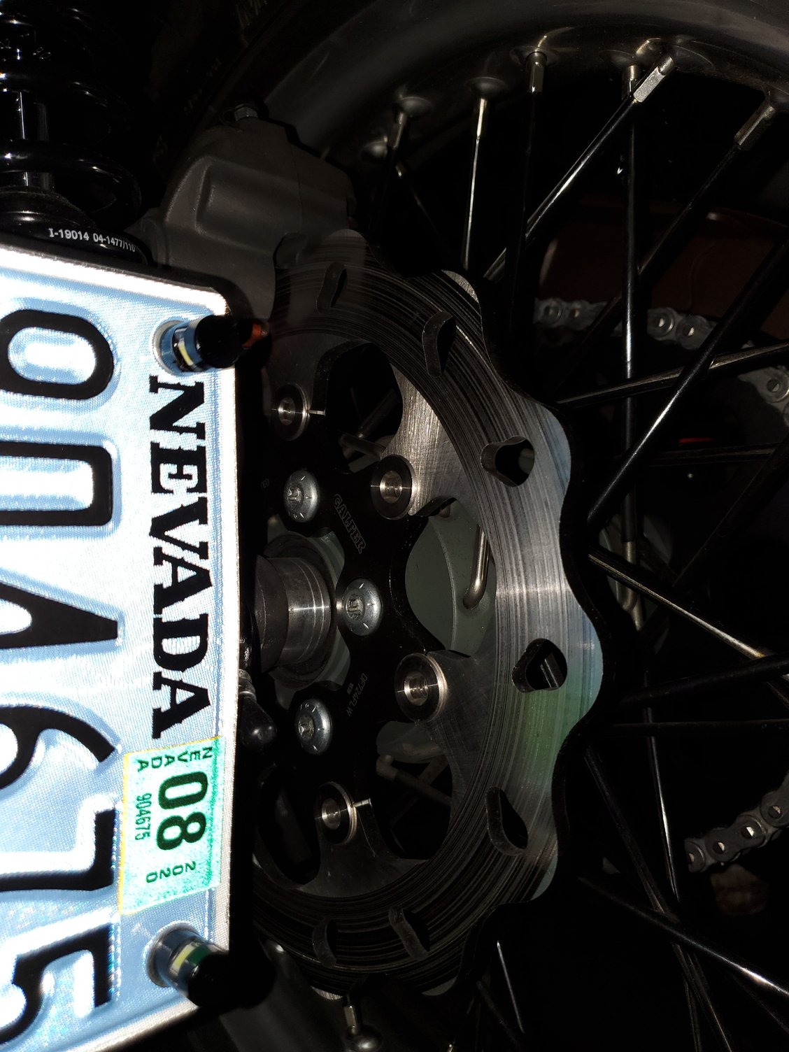

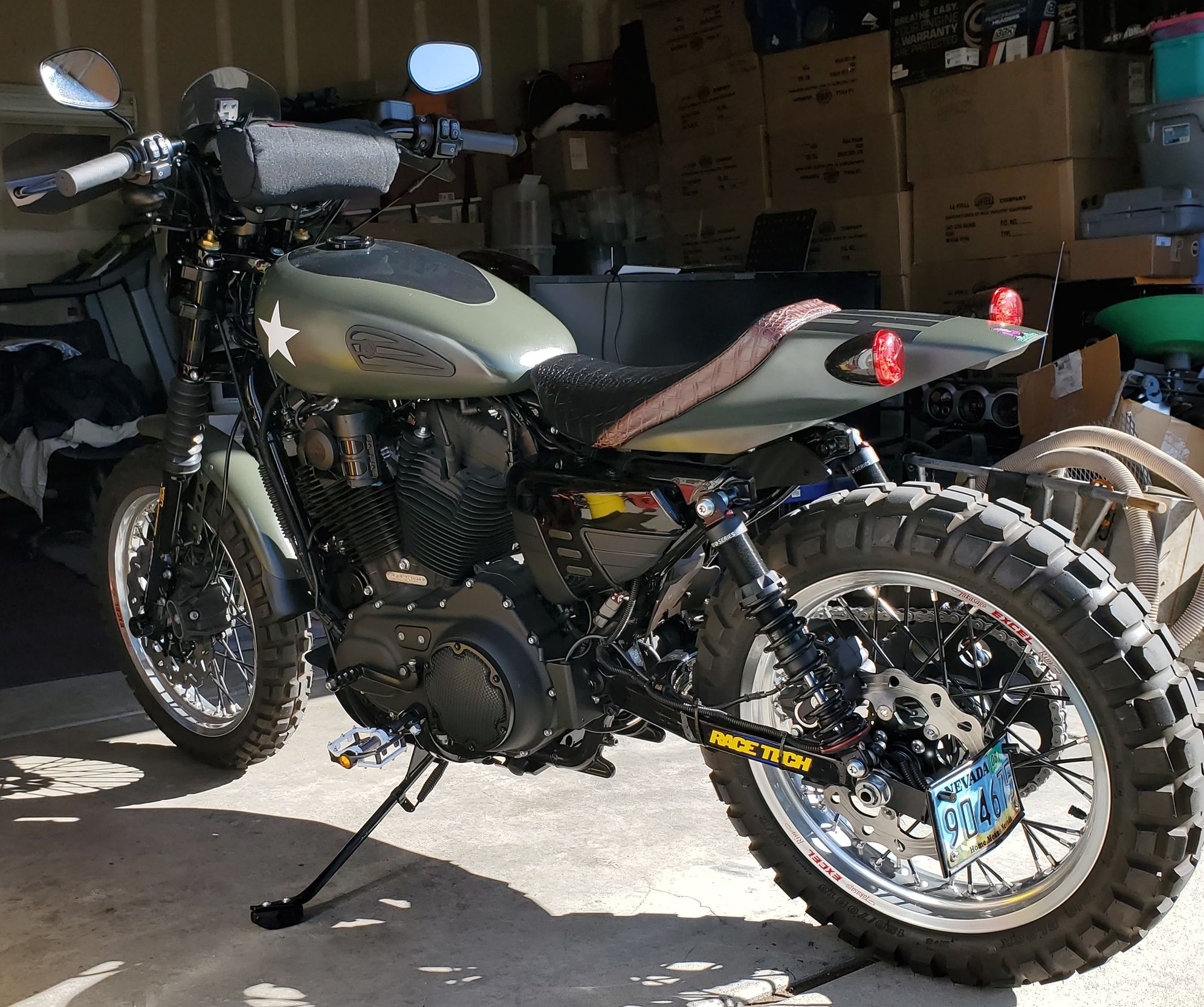

Originally Posted by Hogpro
The rotors are smaller on the newer sporty's and no one makes them. I think they are 10" diameter as opposed to 11.5 on the older models. The last guy I got PM wheels for had to buy a new rear caliper and rotor so that we could get him everything matching.
Galfer makes a couple different floating rear rotors for newer Sportsters. This is one on my 2018 1200 Iron. I also put a Galfer floating disc on my 2012 883 when I had it.
