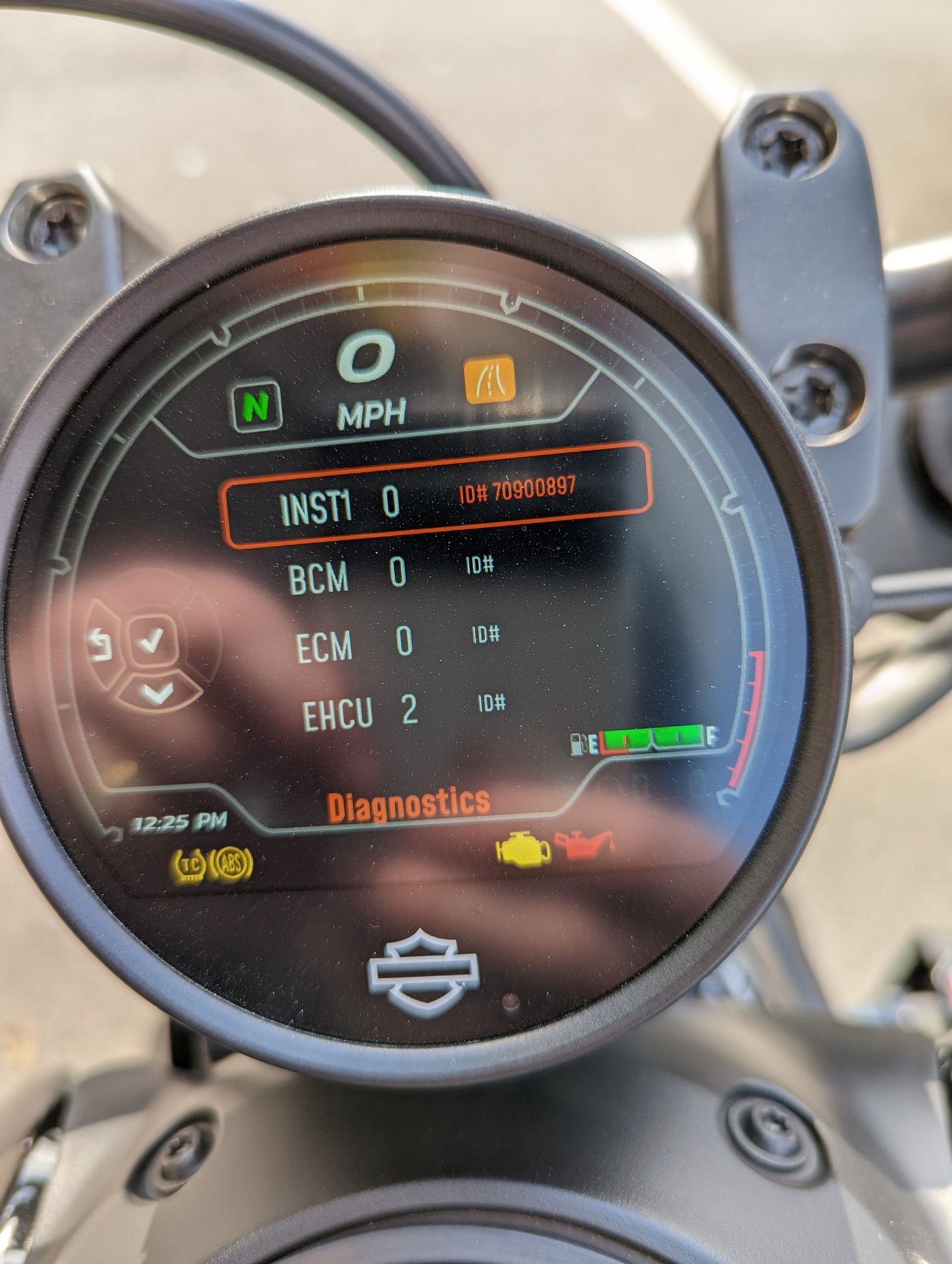

Can you check error codes on display ?
Yes, should throw a code, easier to get to compared to prior platforms.

https://www.advrider.com/harley-davi...s-motorcycles/
Looks like it's related to the software issue that caused the recall. Hopefully a software flash is all that it will take.
Have you called your dealer and told them?

Can you open EHCU menu for see error code ?
and check other modules (list this menu down)

I took one of these on a test ride during summer IMS. Left me stranded too. I was going through the gears and all of a sudden it died and it would not start. Had to be picked up. There was an HD corporate person there that looked at the codes, and in my case, found a fuel line had popped off somewhere under the 1250 cover.
