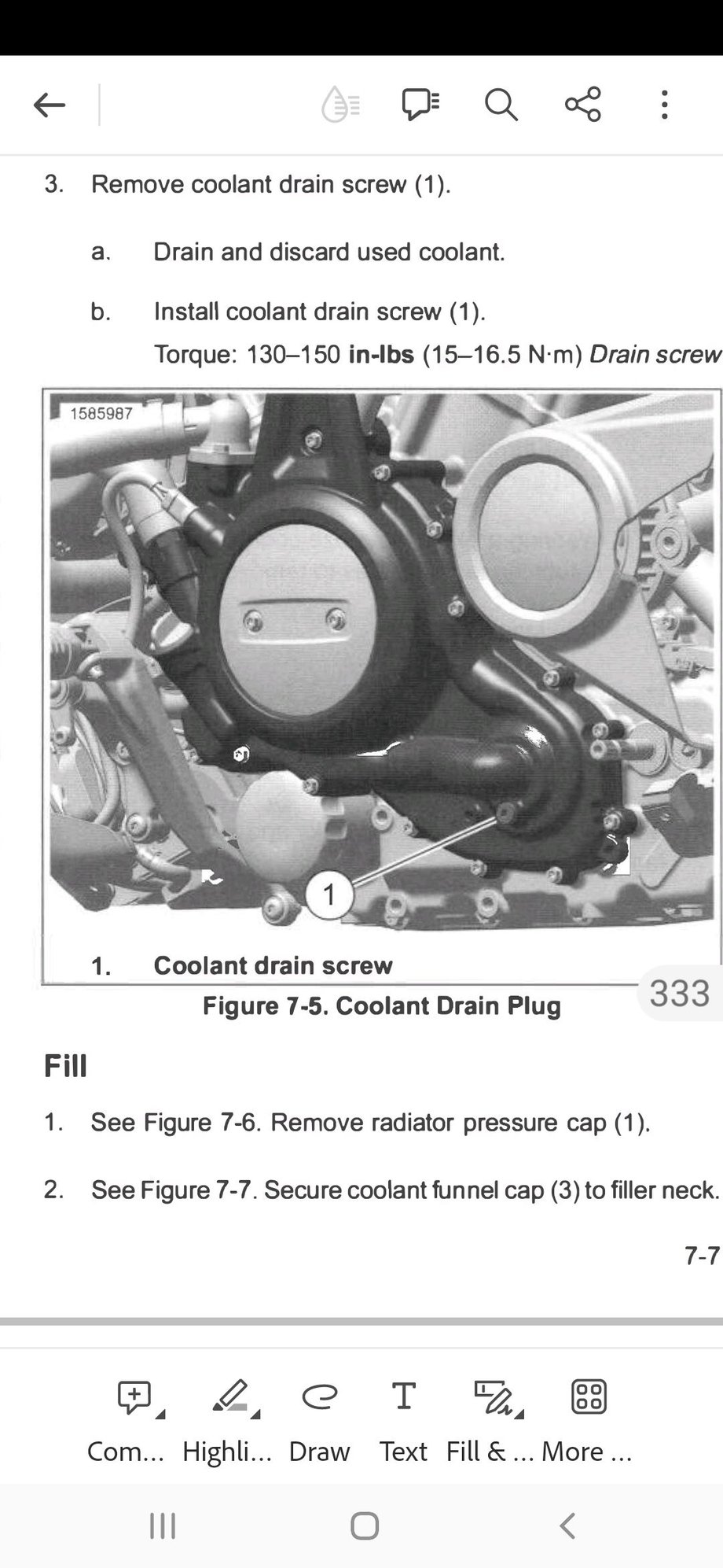

Hello.
I've had my Sportster S for about 2 years now and I'm thinking about changing the coolant.
Has anyone ever changed it themselves?
If so, I would like to know about the following.
Where is the coolant drain bolt located?
Do you use coolant other than the original?
Are there any points that I should pay attention to compared to a regular bike?
Thanks.

If you are going to work on your own bike- i highly recommend the service manual.
Coolant drain plug

You can get one at the dealer- but i just downloaded a pdf version off the internet. Ive also got a 2023 but downloaded a 2022 version- because the bikes are identical- just color changes through the years. It cost me about 20$US.
