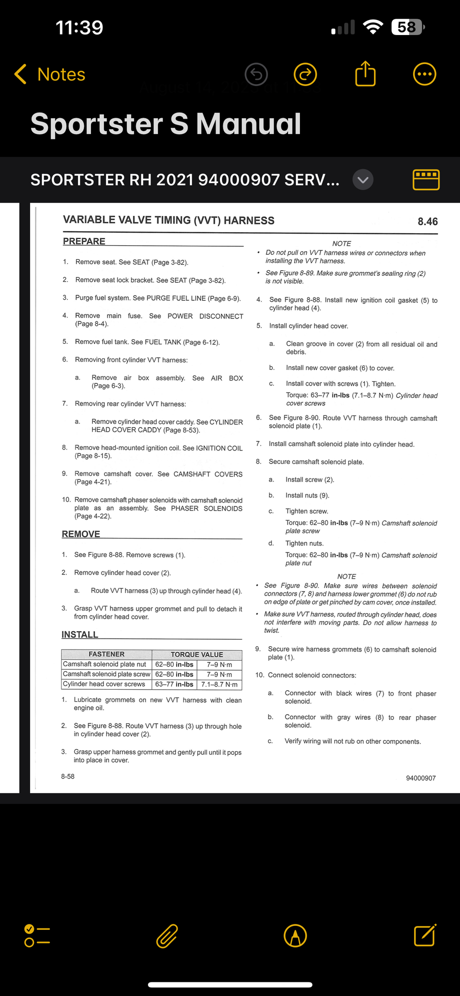

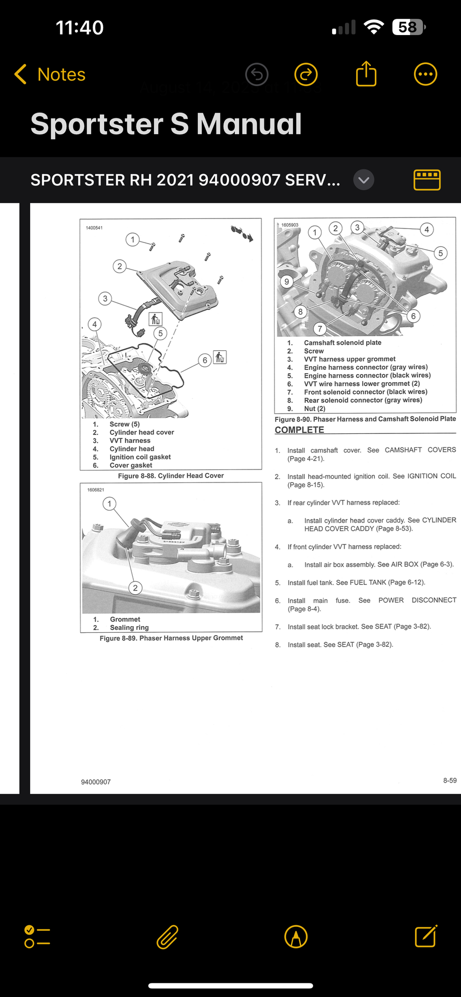

Originally Posted by tvara
Could you please specify exactly what I should check for the VVT control solenoid rear exhaust circuit open issue? For example, should I look for specific connectors, wires, or pins, and how should I inspect them?
I’m no expert but try here.
