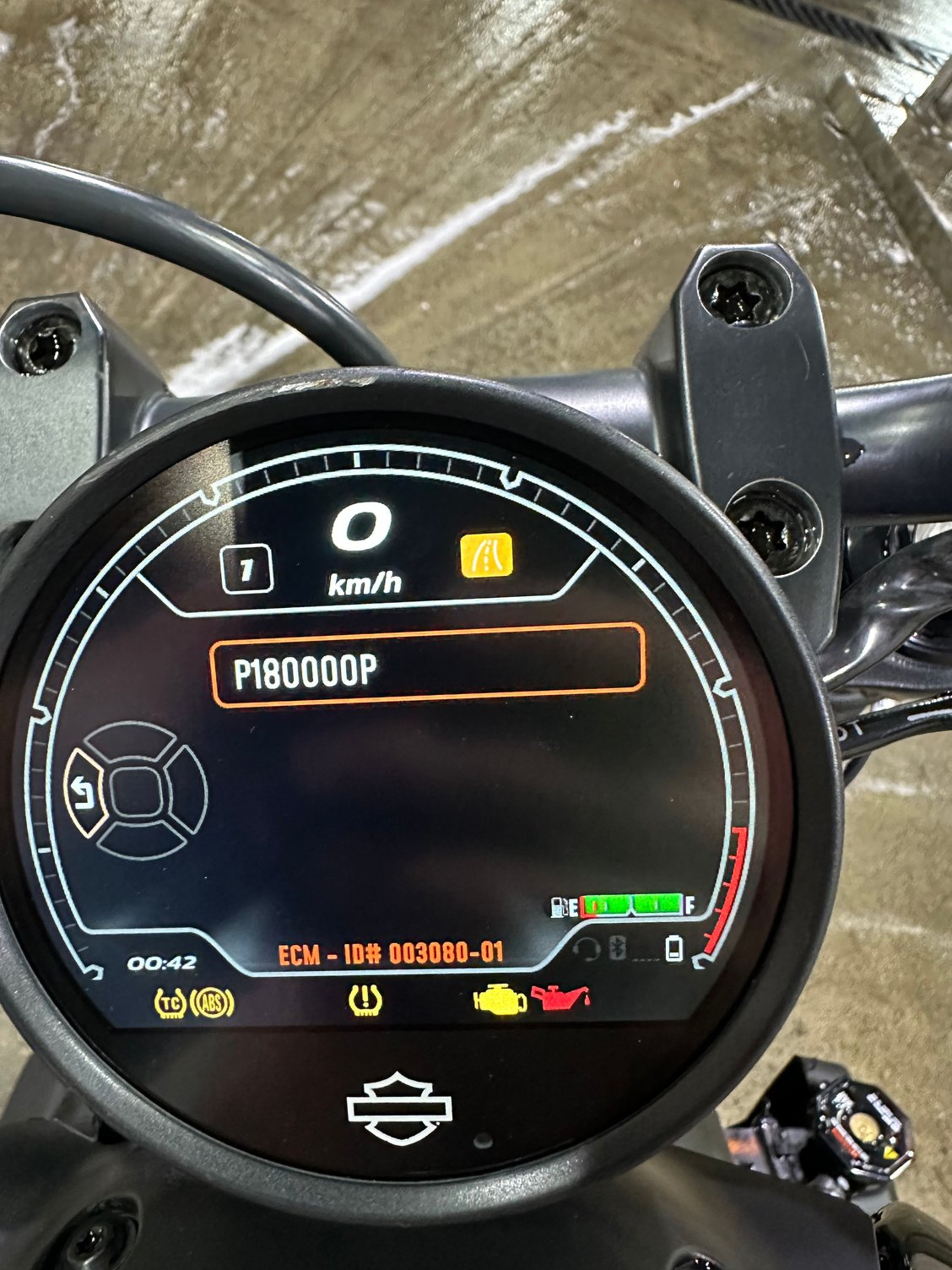

Hi everyone,
I have a 2024 Harley-Davidson Sportster S RH1250 with about 350 km on it. A few days ago, I noticed a serious problem — the bike won’t rev past roughly 3000 RPM, it feels like it’s in limp mode, and it accelerates very slowly. The Check Engine light is on.
I ran the built-in diagnostics and got the code P180000P from the ECM (P module). I can’t find this code in the standard Harley trouble code lists.
Has anyone seen this P180000P code before on a Sportster S? Is it related to the throttle system, ECM software, or something else? Any advice or experience would be really helpful.
Thanks in advance!

Yes- it sounds like you are in limp mode.
i couldnt find that specific code on my google search either- but you are correct in that the P code means powertrain.
id look for loose connectors- wiggle some harnesses- and make sure battery voltage is ok- these bikes seem very voltage sensitive.
keep us posted!

When I bought this motorcycle, the battery was completely dead and I had to recharge it. After that it came back to life, and now the voltage level is between 12.5 and 14.5. Could this still be the problem?

Originally Posted by tvara
Hi everyone,
Thanks in advance!
VVT control solenoid rear exhaust circuit open
I don't understand what you mean. If you don't mind, please explain in more detail what the problem is.
Thanks Jay! Again- if the circuit is open- could be a loose connector- loose pin in a connector- broken wire. Poke around and inspect.
Could you please specify exactly what I should check for the VVT control solenoid rear exhaust circuit open issue? For example, should I look for specific connectors, wires, or pins, and how should I inspect them?
