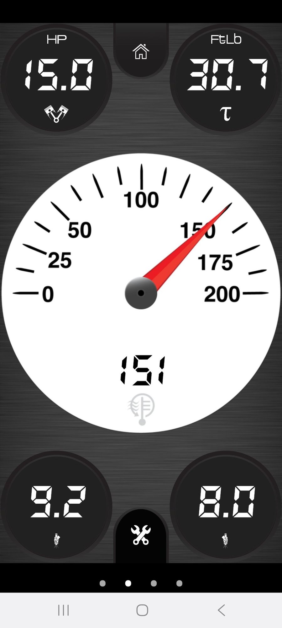

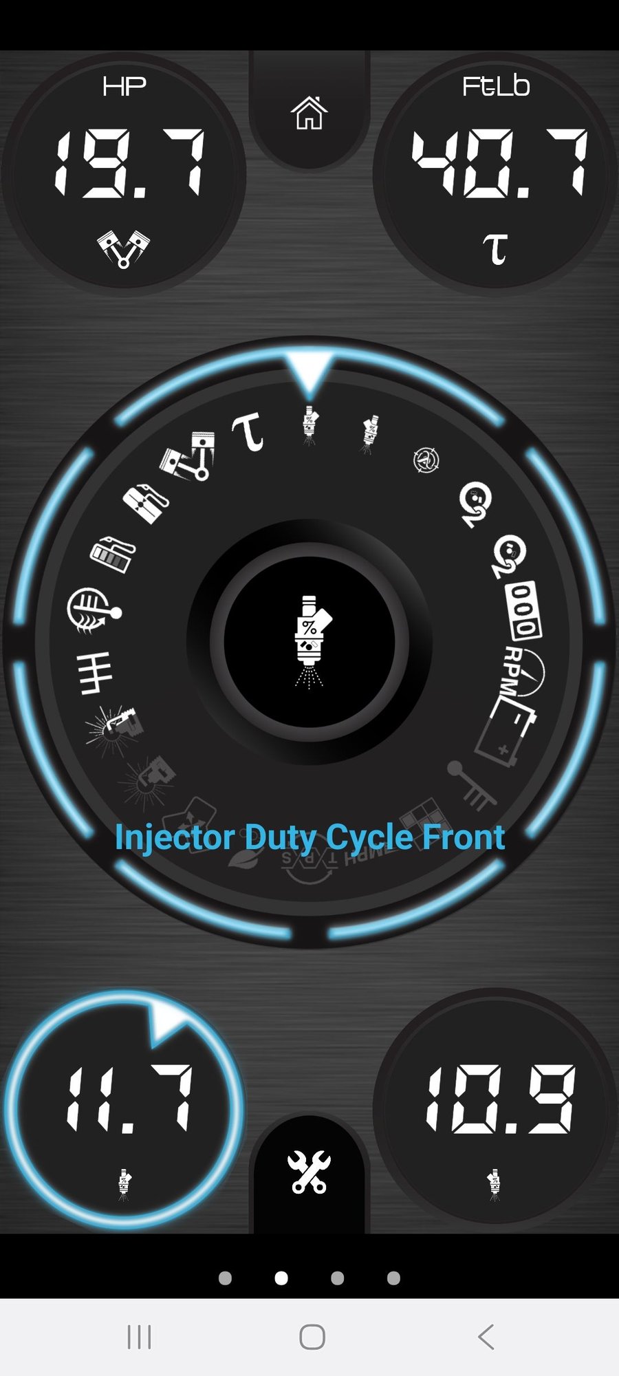

I use a V&H FP3 which is connected to my phone app. I can start the app and see real data on 22 items. Recently I was curious about how much HP and Tq is being used.
IN a safe roadway, I did a hard acceleration in 5th gear from about 40mph up to 90. the MAX torque is was using was 90. The MAX HP I was using was 60.
And just cruising in 6th, 75mph its about 18hp and 36tq. Tq is always about 1.5x higher than HP.

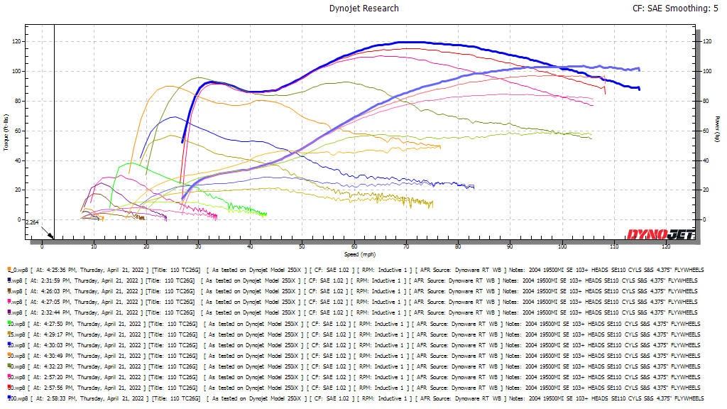

Print sheet (The sheet is a snapshot of WOT.)
Torque is the ability to do work.
Horsepower is how fast the work is getting done.
This is a snapshot of the 2% to 100% runs looks like.
