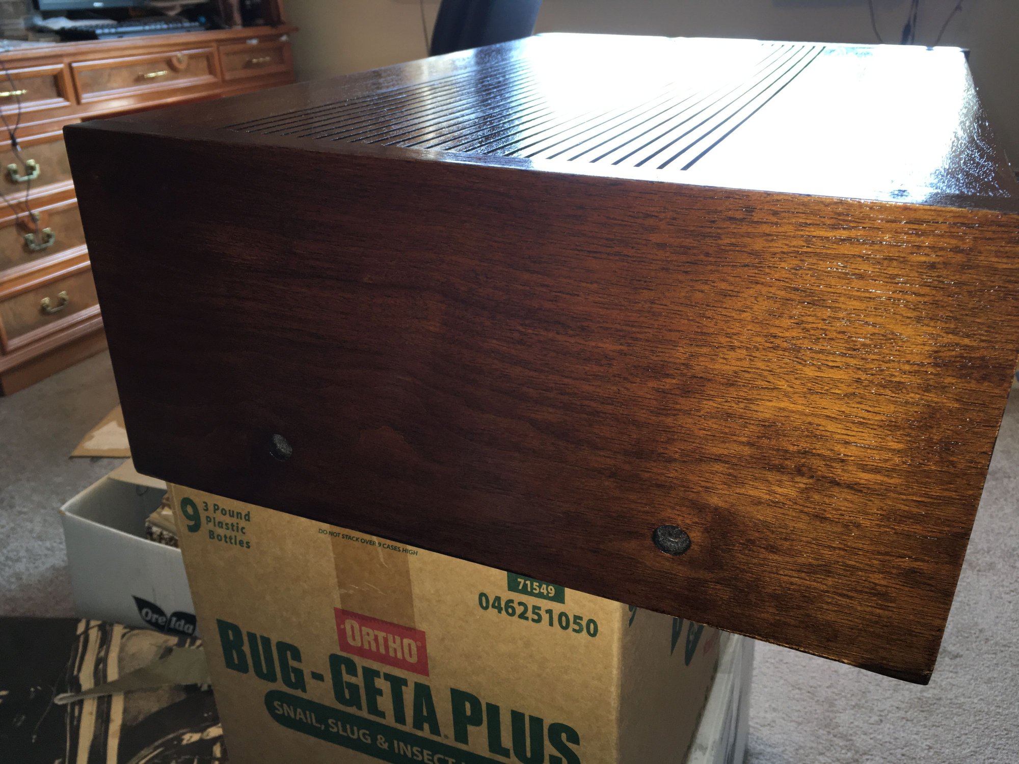

Before that use an old trick a gunsmith taught me decades ago,now keep in mind this must be done very carefully on veneers but on solid wood you can really get after it.
You need a damp rag and a steam iron and you need to keep the rag damp as you work it.
Set the rag on the damaged surface and press lightly with the steam iron using the steam ,keep the iron moving and don't let the rag dry out to avoid burning.
Work it for a minute or so and check it then do it again if need be, This will swell the wood raising the grain.
Again with veneers it can be tricky,too much and you'll loosen the veneer so only a little at a time carefully.
Once the grain is raised you can use sand paper ( nothing heavier than 120 to start with) and lightly sand with the direction of the grain and remove dents and some scratches of not too deep,progress with finer grits to finish. I also like oil finish and topped off with a liquid finishing wax using very fine steel wool.
You may have see the vintage stereo thread and what I did with a pretty rough Kenwood receiver case.
This is veneer so it was a long careful process but it came out pretty good for having been through 50 years of abuse.
