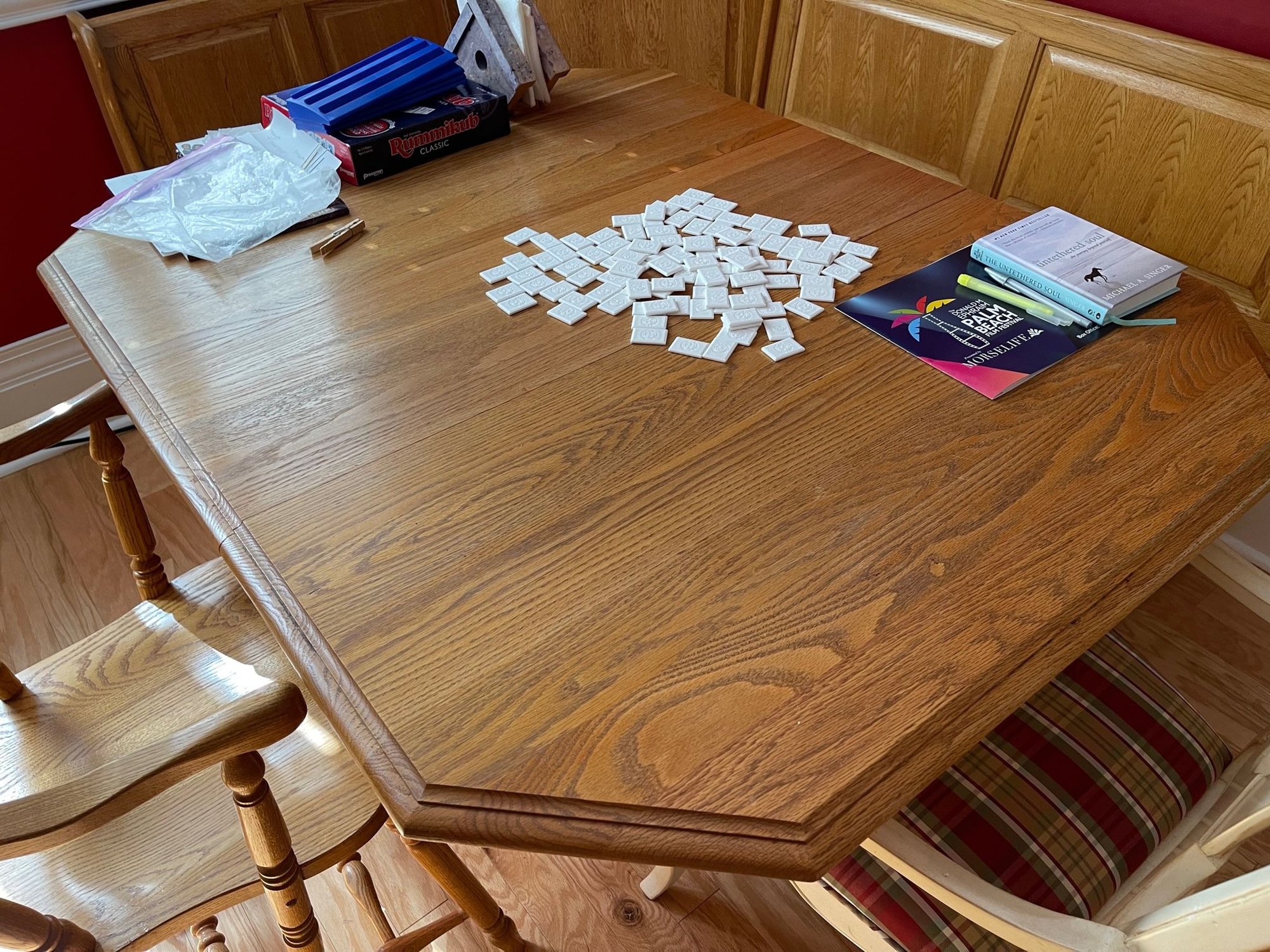

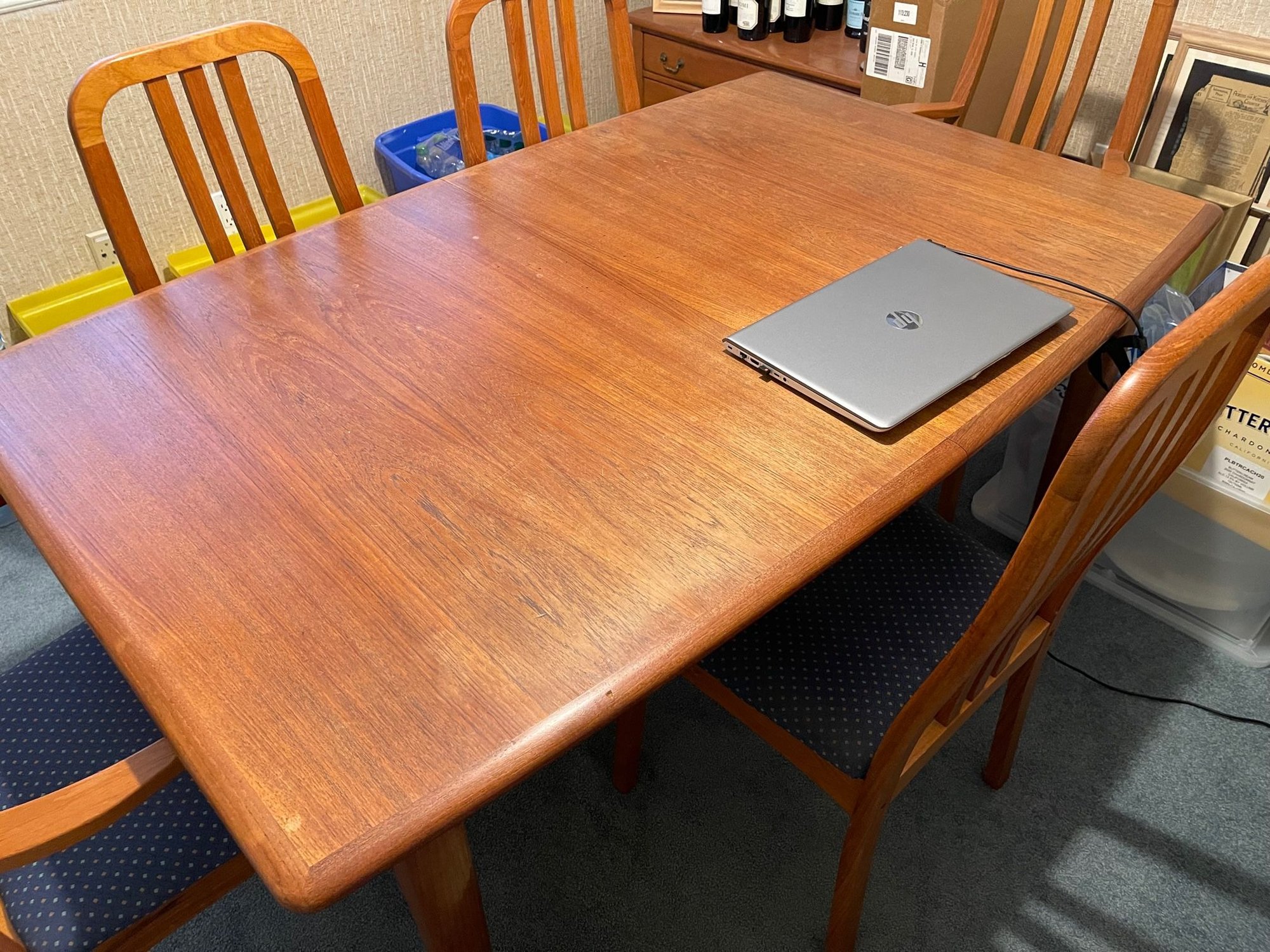

Does anyone know of a GOOD craftsman who can bring back the life to a teak and oak table that was a bit sun bleached?
Palm Beach / Broward County area.

Would it make sense, be feasible if I took PIXs and he could let me know how to repair it? Sand, the grit, stain or shellac or whatever....? Teak and an Oak table. ??

I'll be interested how this plays out, I've never seen teak treated with a topcoat.......

I would think it has some kind of coating on top. (Tho I really do not know.) Sand then varnish? Sand then some type of liquid???
1 guy at a paint store had a liquid coating he said to just rub on it.
A local woodworker said it would take a day. He would pick them up. Sand and do something, then return them. He pissed me off about something so I said no TY............
I agree HHP, interesting to see how all this plays out.
How ever it plays out above, I likely will see if I can have it collaborated before I do anything. Would hate to ruin the 2 table.

I may be able to help with some advice. I am curious, what part of the table is Teak?, the picture looks like an Oak table.
You would generally not put a film finish on Teak. Normally I would sand the surface to 220 grit with the beginning grit depending on the condition of the surface, and then apply a few coats of Teak oil. The Oak would depend on the type of finish on it now i.e. Lacquer, varnish or polyurethane, as how to proceed.
Please provide as much info. as possible about the table and I will try to coach you on process.

BC7, I just took another look and realized it appears you are talking about two different tables, one Oak and one Teak.
