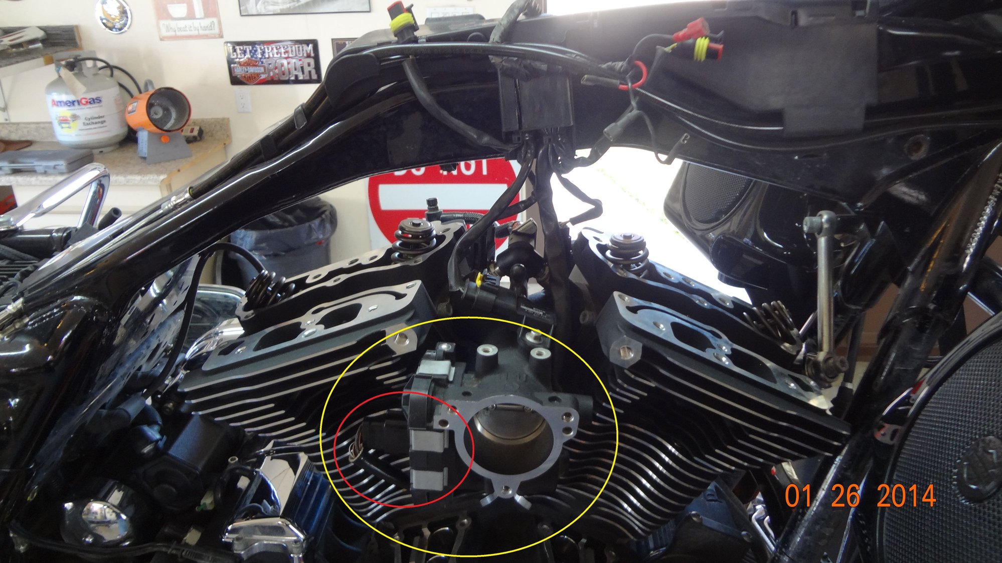

Pull apart the connection behind the air cleaner and put a little dielectric grease on the pins and put it back together snuggly. Very common problem.
+1.. good catch pat.. this is the connection pat is referring to.
