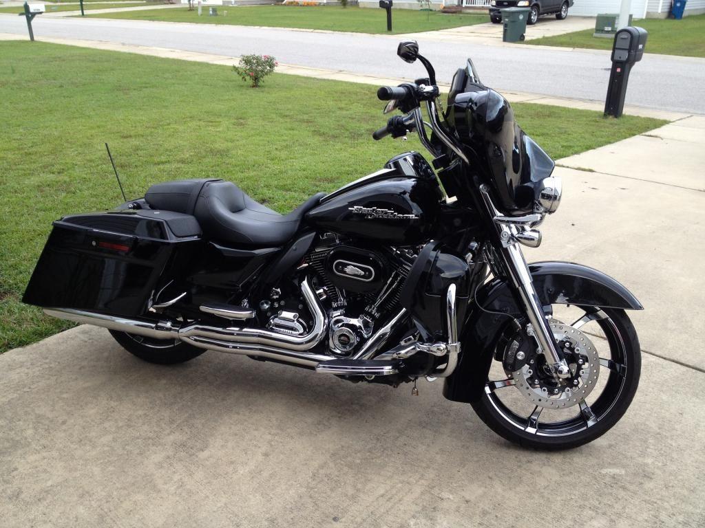

The last time I thought I would just use mine during certain seasons was when I bought them three years ago, haven't been off since unless I'm doing a good detailing of the bike. They really do make a big difference.
Good luck with your choice, I have a Mutazu king tour pack and the paint still matches my vivid black 2010 after about 4 yrs of hard use and many miles.

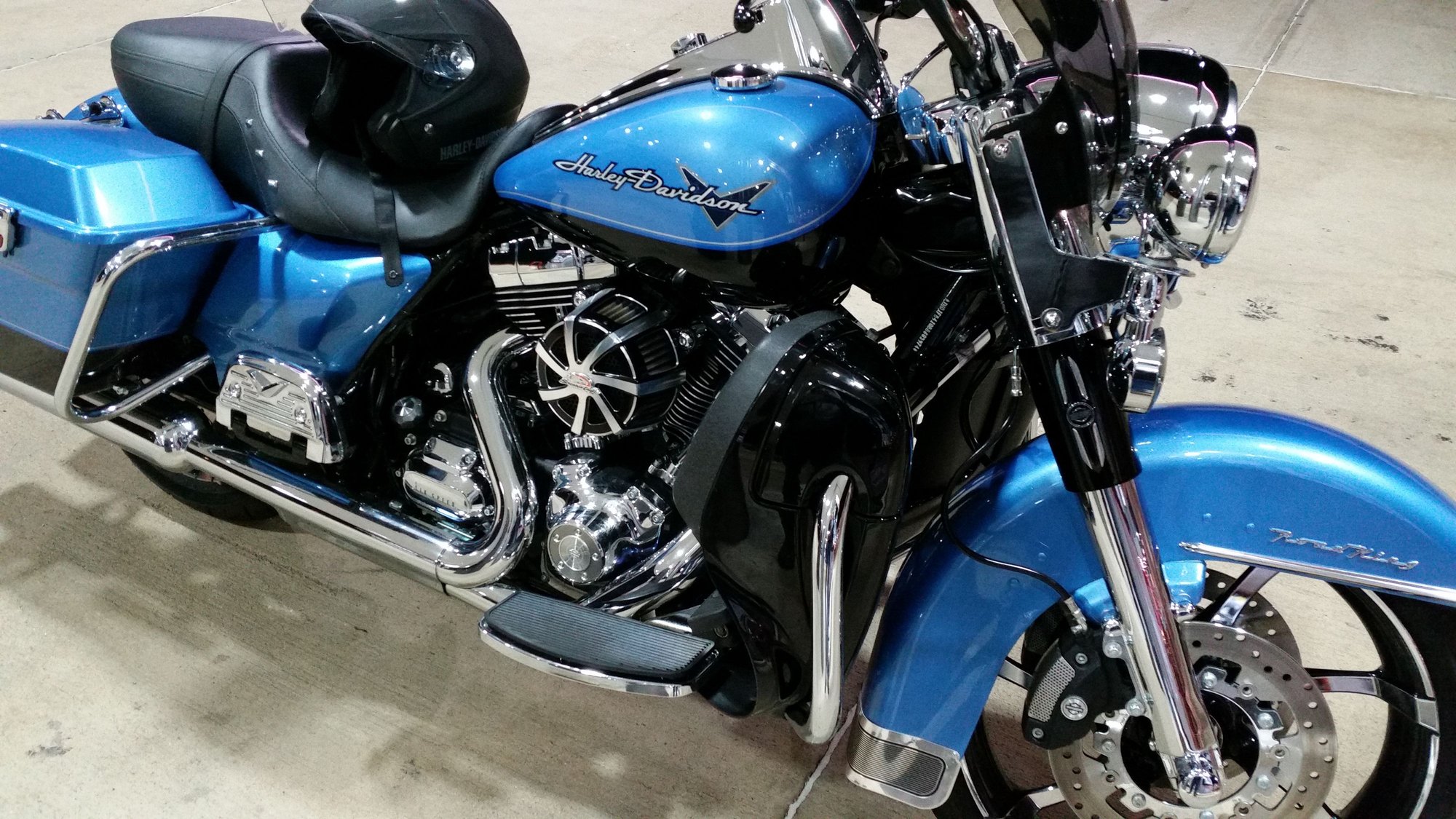

I bought my vivid black lowers from eBay seller Tmshelmet last year and I'm really happy with them. I see they're even cheaper now at $70 plus $20 shipping.
The only hardware I bought from Harley were the clip nuts that hold the upper caps on and the vinyl cover clamp that holds the bottom of the fairing against the crash bar. Everything else I bought at Lowes including the elevator bolts, lock nuts and rubber washers I used to secure the bottom of the fairing to the clamp. The glove boxes can be assembled with short self tapping screws and carriage bolts with lock nuts can hold the vent doors together.
I wasn't happy with the glove box flaps that came with the lowers, so I bought locking doors also off eBay.
BTW....HD Rolling..... That SG looks awesome!
