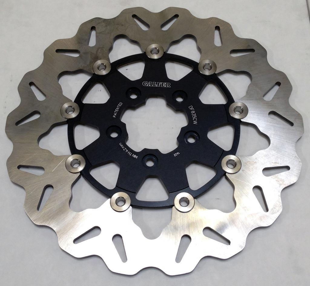

While we are on the subject we have got a few sets of the brand new Galfer Wave 11.8" fully floating front rotors. Unfortunately as of now I only have 1 of these rotors left in stock but I am sure I can get more. Galfer makes racing rotors thus will hopefully take care of the warpage issue that many encounter. I had a bunch here and they are all gone but it has only been a week or two thus too soon to tell if this is the solution.
Here are a few pics of the rotors.
If you interested in a set of these I have introductory pricing. Please call or PM for more info.

Originally Posted by slammed05fatty
do they have a chrome option?
Not yet. Usually with a true floating rotor such as this chrome is not available as the added of the thickness of the chrome throws off the rotor but they will have either a polished aluminum of maybe chrome available in the future. No word on when this will be available. I have two of these rotors left in stock with the black center as pictured. Introductory pricing is $225 per rotor on this batch, retail is $325 per rotor.
Drew
