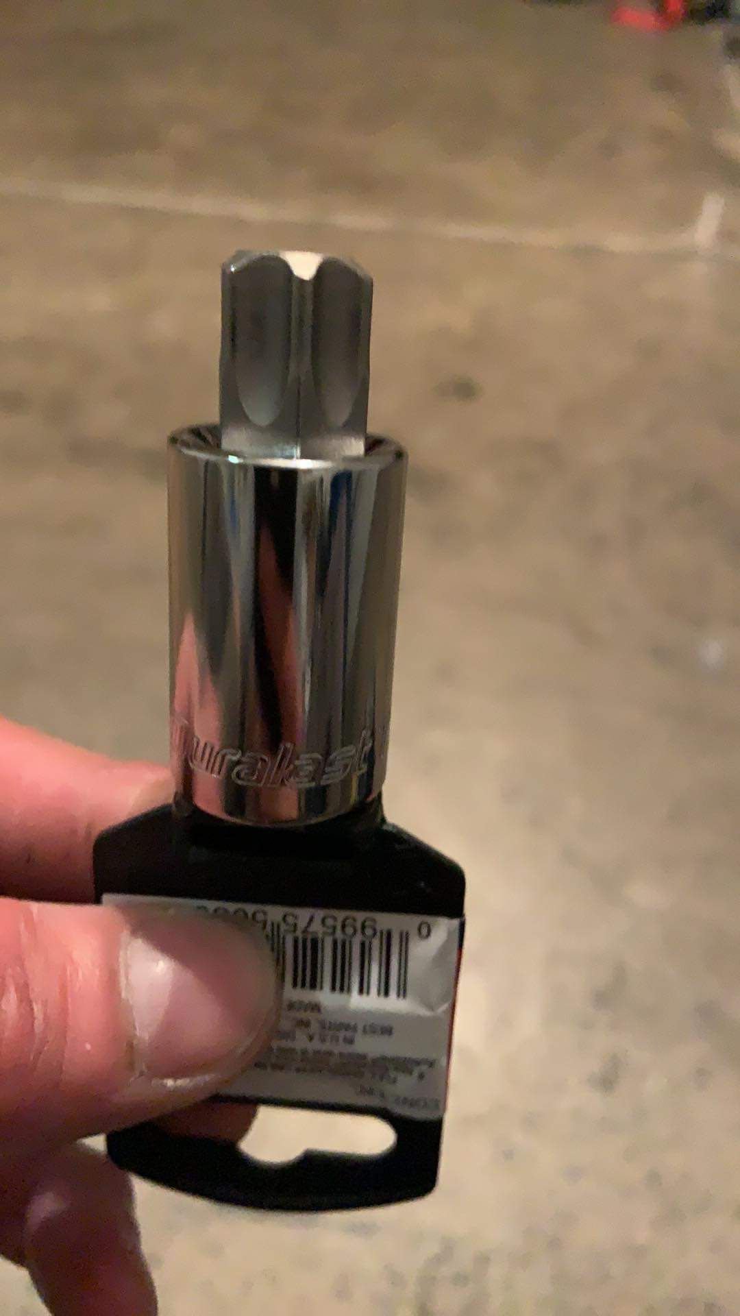

Originally Posted by Deserae Durbin
I’m the more computer savy between my husband and I so when I was looking up the socket and tools need to remove the Clutch basket on my husband 06 Soft tail deluxe I came across this forum and also got the socket from autozone as suggested ...however 🤔🙄🧐 it dosent fit in the barrel entirely because of the outer casing so to say ? Am I missing something here ? If anyone could please help it would be greatly appreciated
The T-70 is for newer bikes.
That is a nut he's trying to put the T-70 into the center of. It takes a 1 1/2 inch socket. That's to take the compensator off.
Since you'll get there soon enough, the clutch nut is a 1 3/16".

Originally Posted by Numa Albornoz
Truth!
Inserted
You need an 1 1/2” socket on that nut. Not the T70, which is for the latest screaming eagle compensators. If you have a service manual for the 2006 year touring models, it tells you right in there to use an 1 1/2” socket. If you don’t have a service manual,I highly recommend you invest in one. I will save you a lot of headaches and give you all the torque specs you need, which are very important for any bolt going into aluminum.

Originally Posted by btsom
And mention that the clutch nut is left hand thread, or at least it is on an 08 Road King.
Once again, this is something that’s explained in detail in the service manual. I can screw things up with a service manual. I can only imagine the damage I could do without it!
