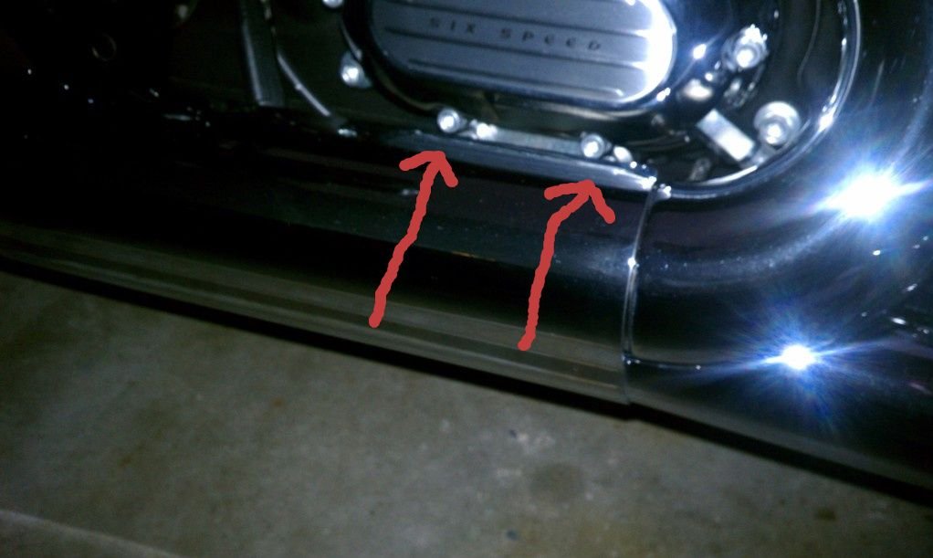

Another minor issue is the two bottom-most bolts on the transmission cover that also serve to secure the header bracket. These two bolts are notorious for vibrating loose and creating a transmission fluid leak. Here's a borrowed photo of where they are located:
Photo courtesy of forum member 2wheelin
If loose, you can re-tighten them with an extended ball-end Allen. Can't remember the size. If you ever remove the header for any reason, then remove the stock and replace with some grade 8 bolts using a lock washer and red locktite. They won't vibrate loose after that.
