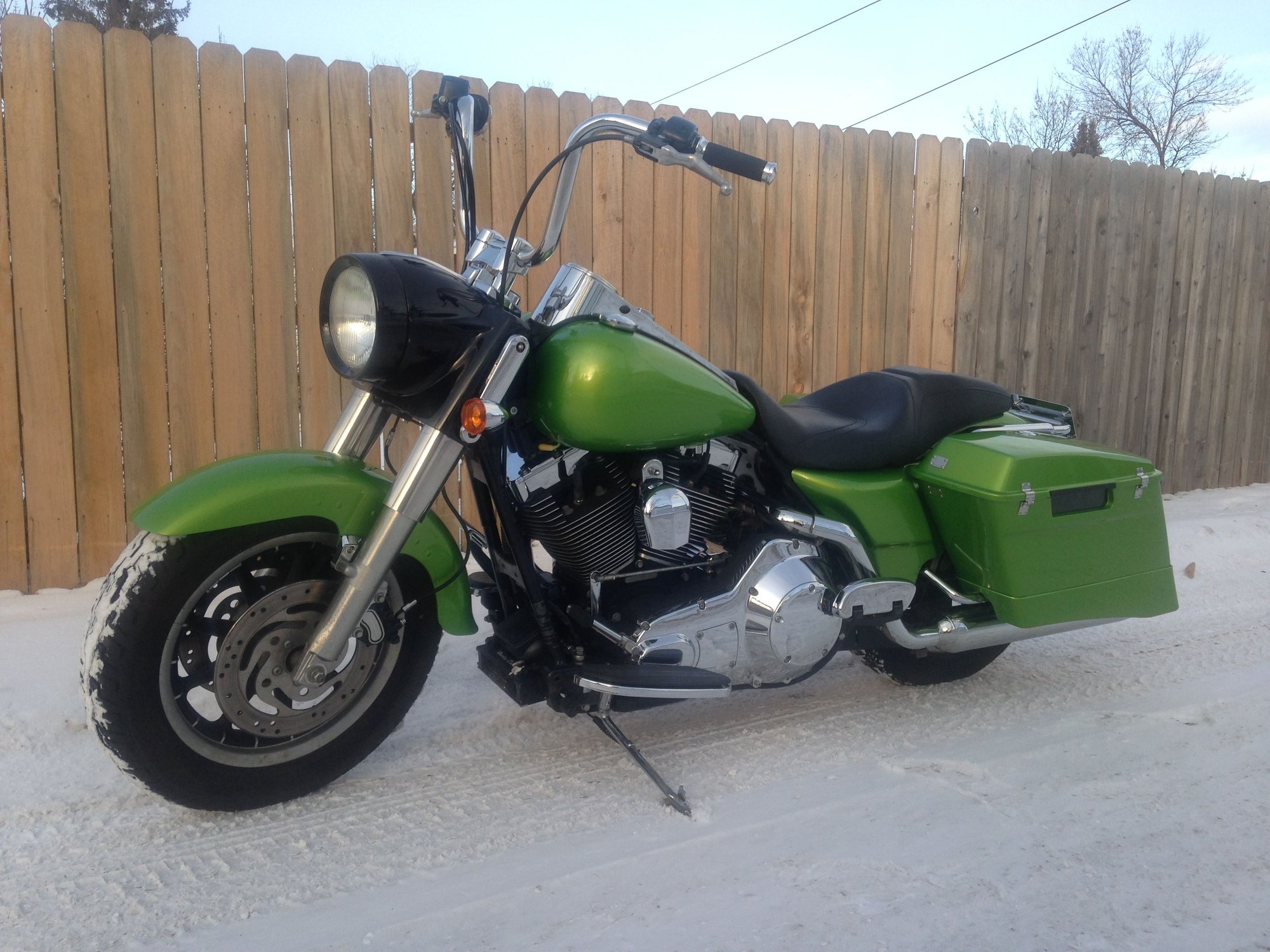

Here's a shot of the FB fender mentioned. 2002 bike, No idea what year the fender is from. I know the wheel looks like hell, It has been replaced since the pic was taken.
