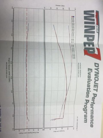

mine was a 96 to 103 done by Kutter with TW555 cam.. corrected dyno results in my sig. has been a very respectable and reliable build for me.
