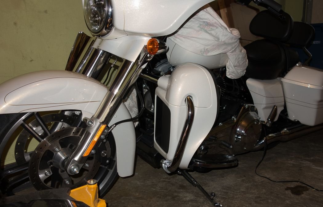

I put one of my lowers on and had enough clearance for the fang.
The little fairing wings did the least, windshield and fangs are first.

That is super helpful guys, thanks. And thanks also for the pic, Mike, showing me how they look together. When I searched this topic in the forum there seemed to be just as many guys who say they work fine together as say they don't. I really like the look and functionality of the lowers, but I don't want to give up the fangs, as I really felt a difference with them on. In in the prairies, near the foothills of the Rockies, and we get some pretty crazy winds out here in the summer.
