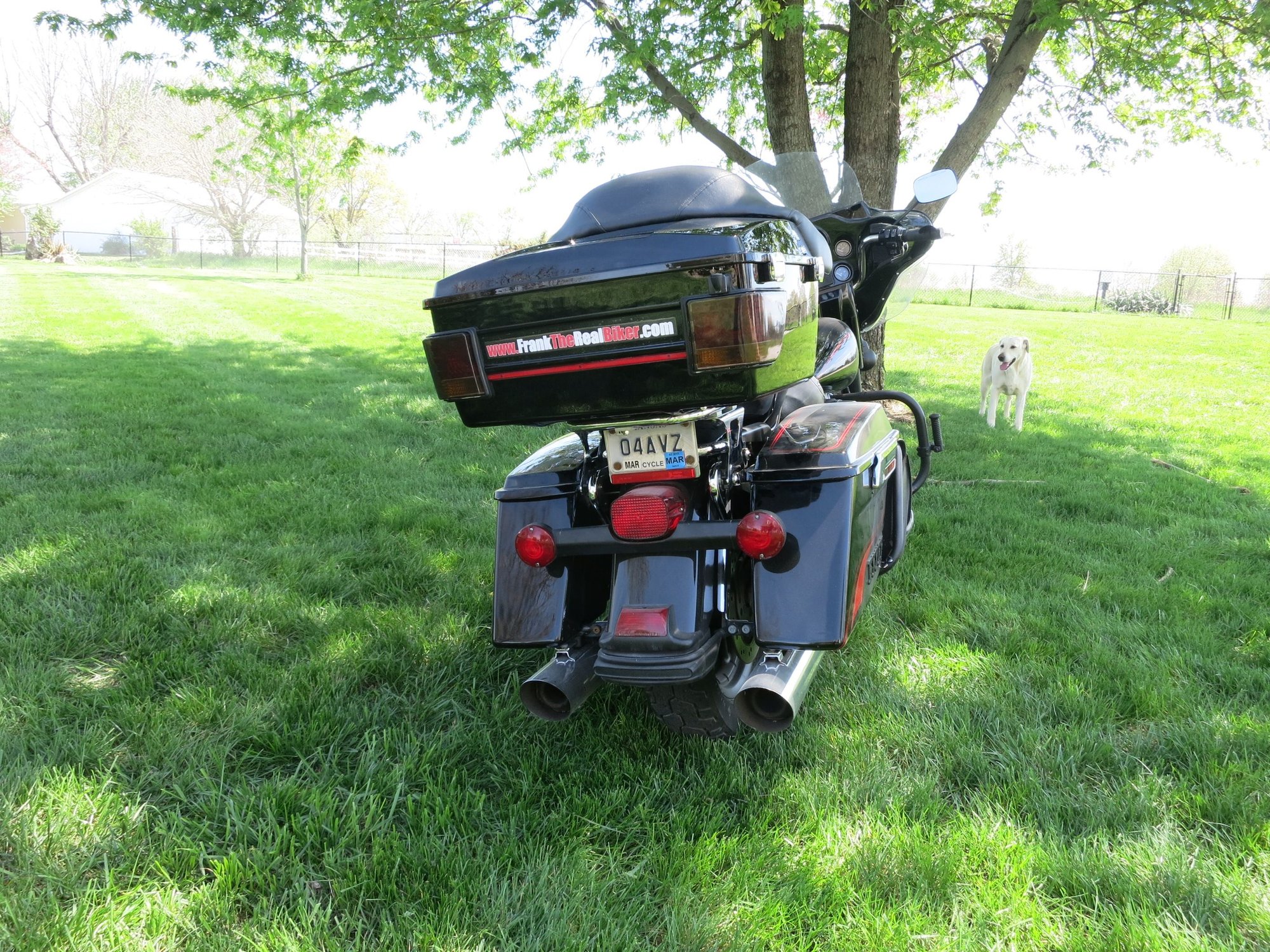

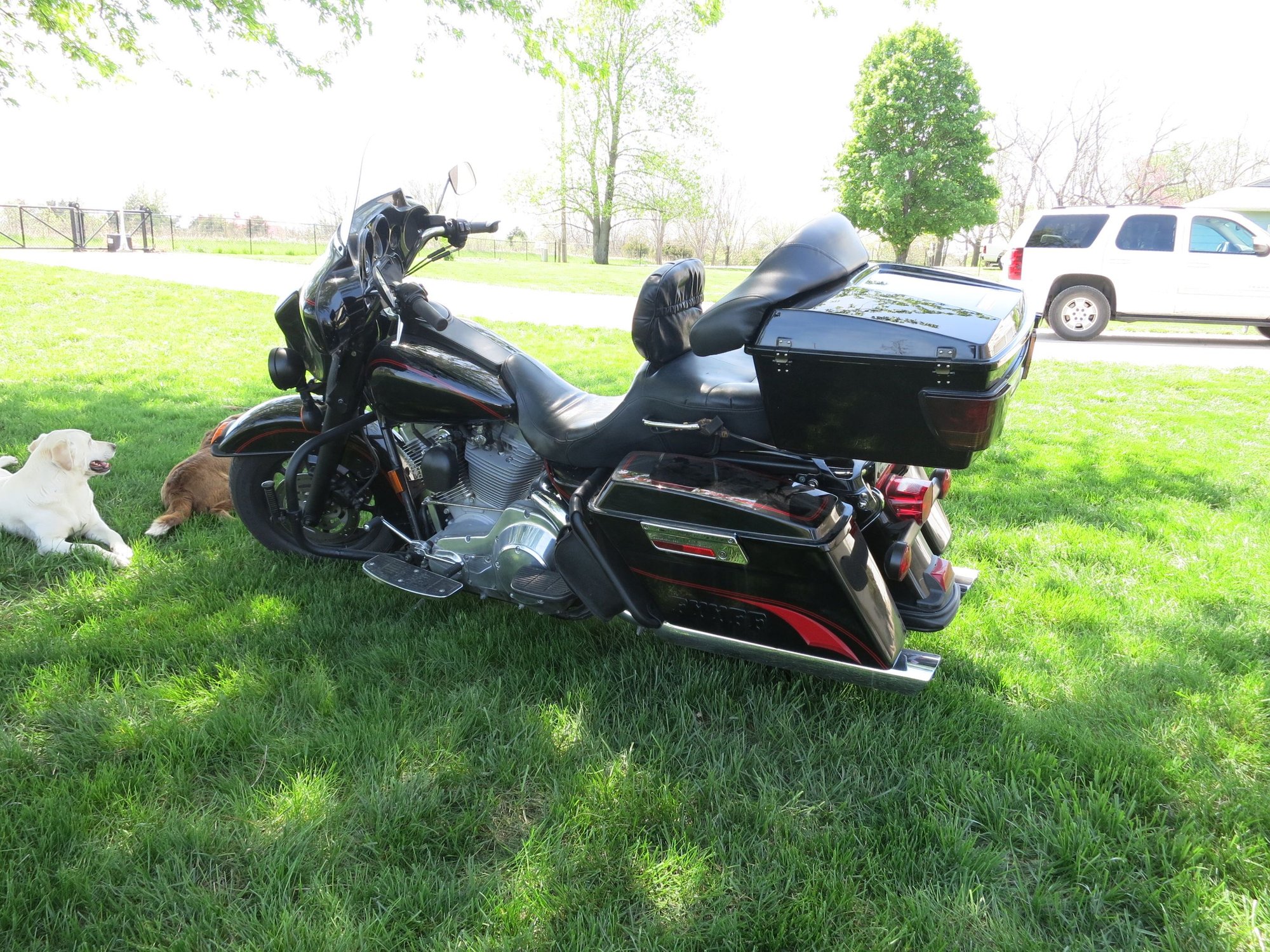

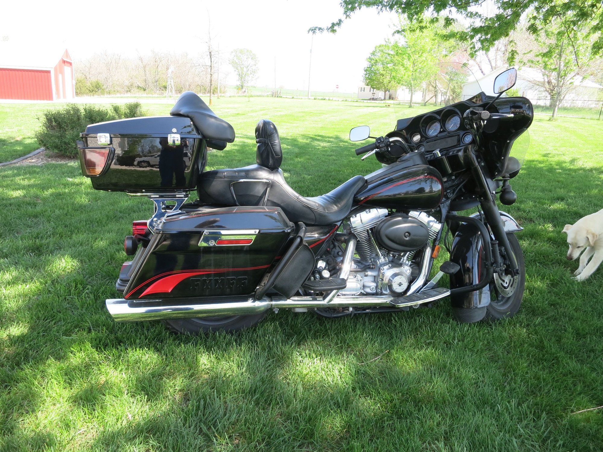

I had the one mentioned by the OP. It worked fine, held quite a bit, was kinda unattractive. Last year I bought the Mutazu King Tour Pack knock off. Spent the $385.00 as noted above. I replaced the hinges and latches with HD parts including having it keyed to my bike. It looks identical to the HD product. It's perhaps a little more flimsy, but is robust enough to last a long time. Here are a few photos of mine. The outdoor photos are before I put on the HD hinges and latches. The bottom two show the new hinges and latches. Sorry for the poor quality of those two.
The Mutazu knock-off tour pack isn't perfect. It has it's drawbacks, but they aren't necessarily deal breakers. Here is a link to a page on my website. It displays the good, the bad, and the ugly that I experienced with mine.
Last, I replaced all the incandescent bulbs that came with it with LEDs. The lamps are wired together but terminate with loose ends. You are required to wire 'em up the way you want. I chose to use a circuit and some relays and made mine tail/brake/turn signals. Ran the wires out the bottom and used a 6 pin trailer plug/socket and tapped into the existing wiring for the lights. Works fine!
I'm satisfied with it. I'd buy it again if I needed to. YMMV, BWTFDIK.

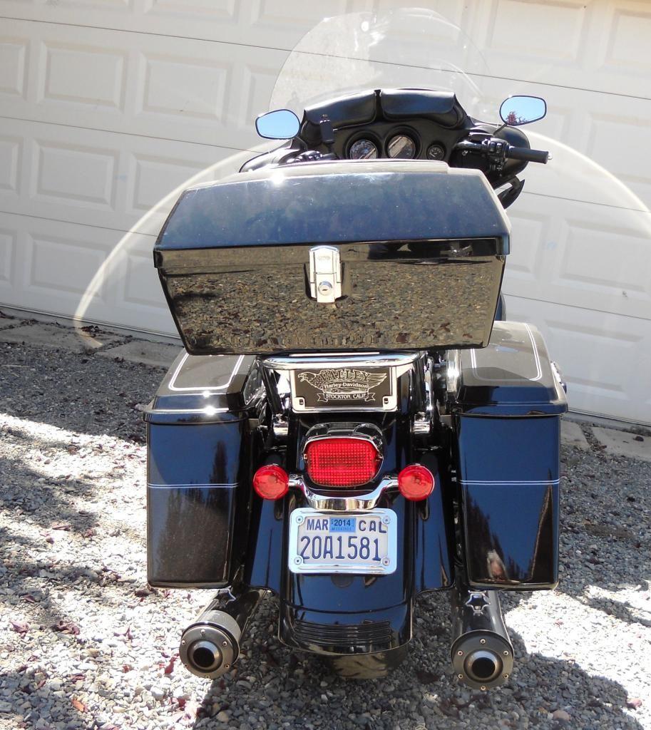

When you say we are you meaning you and your wife? If she rides with a TP on once she gonna want it all the time. I sucked it up and got a new style TP. It's bigger, looks better, sits farther back, and is more comfortable for the wife. Well worth the money to me. For the most part its only on the bike when my OL is.

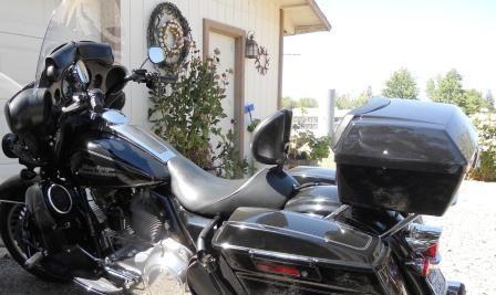

Couple older photos of my Mutazu one mounted. I have since added a cheap ebay rack. It is holding up just fine. Only problem is folks want me haul their stuff...

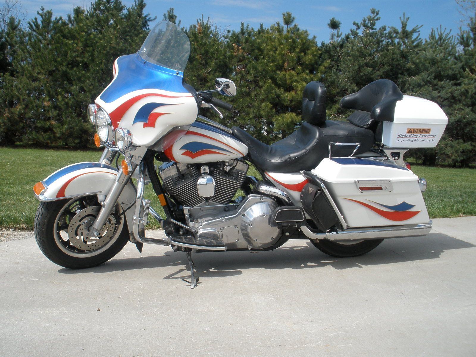

Photo of mine with the smaller Mutazu tour pack taken a few years back. Nothing really wrong with the style...just different than the King.
