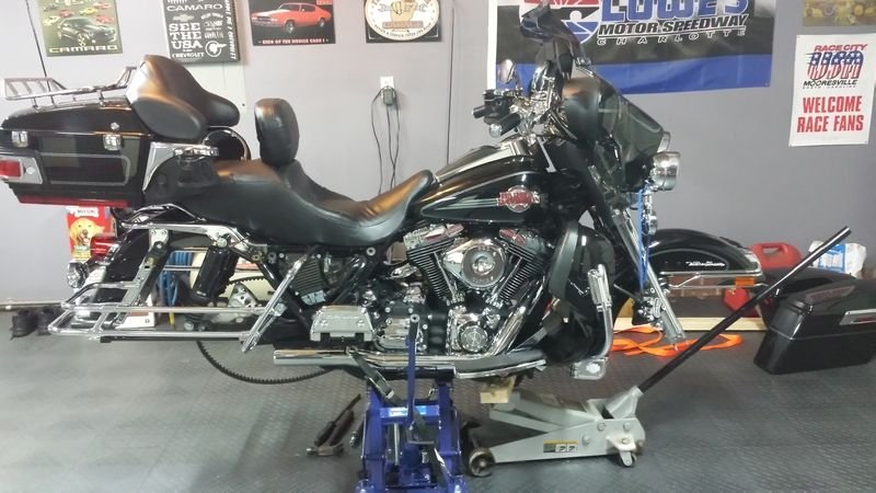

2007 Ultra Classic 15k, never leaked a drop, just jacked it up last weekend to remove the wheels so I could change the tires, planned on re-installing them this weekend, I noticed last night as I walked by it, a puddle under the front, looks like it's coming from a switch/electrical connector just inside from the shifter a couple inches? Basically running down and dripping off lower case. Anyone else had this problem with the bike sitting level instead of on kickstand? That's basically the only thing that has changed is the angle of the bike. What is that switch for, tranny fluid too high? Thanks in advance for any help.

Originally Posted by Nikogto
How well does the jack move around on those knobbed floor tiles with the bike up on it?
I've a shed that the previous owner leveled using a dead opossum or such. I've been thinking of sorta leveling it with some tiles like you have there.
