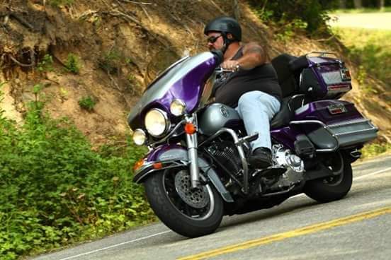

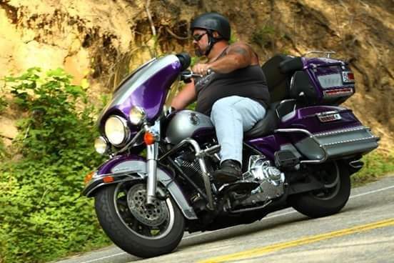

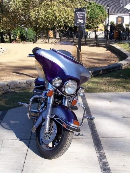

Old Apr 5, 2015 | 11:01 AM
REPO1's Avatar
REPO1
Posts: 303
Likes: 21
From: Fort St.John, BC
Great looking bike!
